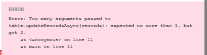

Michael_Andrew
Forum|alt.badge.img+23
How does that alter the code? I don’t think I can just put the ‘s’ in as the this will have an error.
