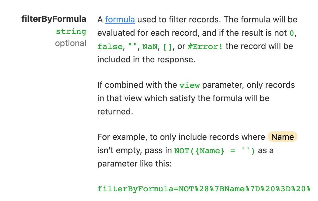

Either way, once you have your parameter value “bill-gates” you can pass this to the Airtable API call using “filterByFormula” and just return the Bill Gates record.

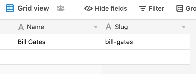

You could set up your table like this:
Or you could just user the name field, lower case it, replace spaces with hyphens and so on.
Lots of way to approach this, but the key element is to use the “filterByFormula” param on the API to get the specific data you want for each page.
