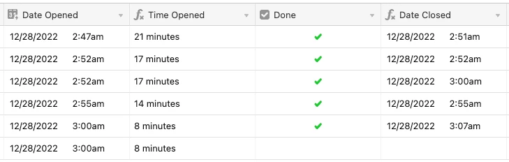

Hello,
I have 4 columns setup.
Date Opened - is a created time field, logs when an entry is created
Time Opened - is a formula field with the following:  TONOW({Date Opened}) - Simply logs in minutes (will likely change to hours) how long an entry has been opened for.
Done - Simple checkmark box
Date Closed - Is a formula Field with the following:
IF(Done = 1, LAST_MODIFIED_TIME(Done)) - simply logs the time an entry is marked as Done with a checkmark.
My current issue is, I'd like Time Opened to stop counting as soon as Done is checked and I cant quite figure out how to do this. Does anyone have any pointers?
Thanks!
