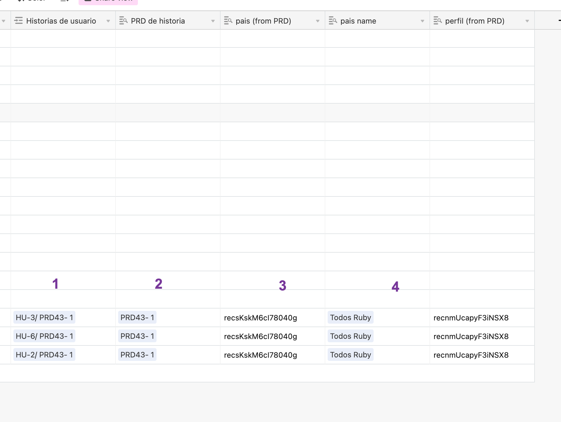

I select from [1]. a linked field, lets say HU-3/PRD43-1
Automatically with a lookup i get [2] and [3] and [4]
This field [4]. needs to be “copied” in another linked field i [5] in the same record
Thats the point… i am trying what you say
but , im stucked.
Nothing works.
If you can give me a solution, I will be very grateful

This is very easy actually :slightly_smiling_face:
You just need to input the correct values in the above fields.
Record ID is the Record ID from the test step and the field you need to update “Prefil comprador” should have a dynamic value of “Pais name”

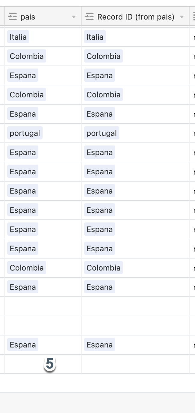

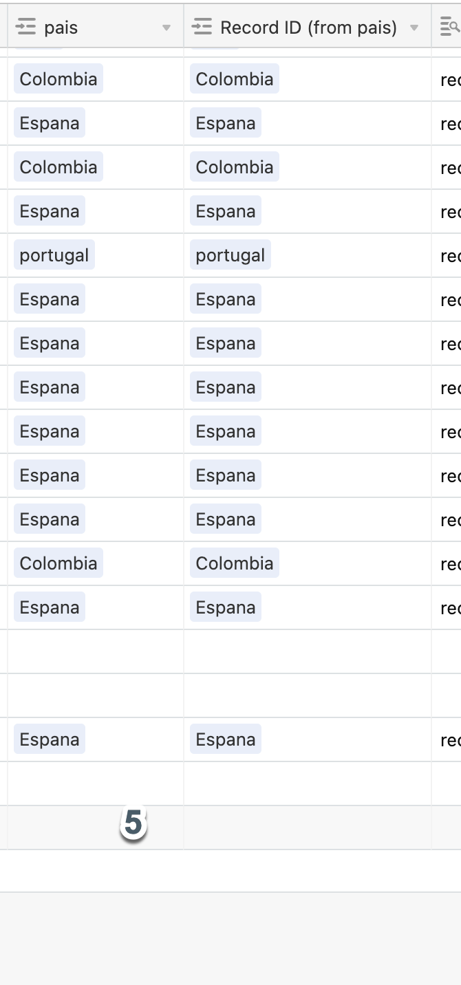

I made a mistake
[5] is pais
but then i try this
and then I input [1] that automatically puts [4]
but not [5]
it is still empty…
automation is not working, and i dont know why
:frowning:

The trigger is incorrect. It should be “When Record Matches Condition” and the condition should be 1 is not empty and 5 is empty

Many thanks,
it works like a charm!!!

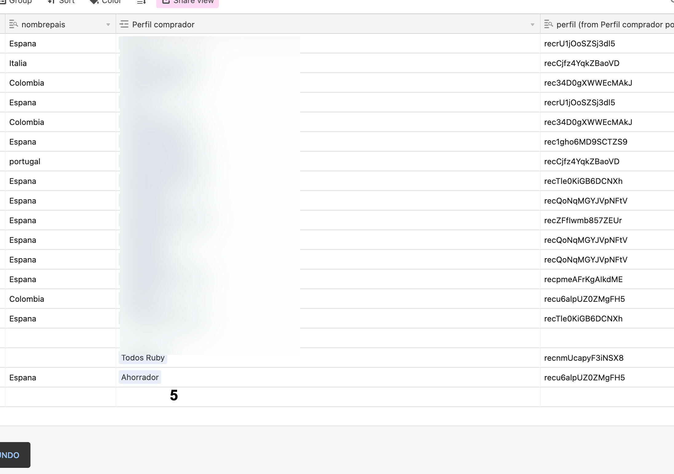

The only problem is that changes in [1]. as it is a linked record from other table, is not reflecting in [5]
it is like [5] is static after the automation.
Some idea?

You mean that 5 can change? In this case we need to think of another trigger. Maybe when a field is modified and make it watch 1?
