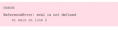

eval won’t work for me in an automation action script. I get an error saying that it is not defined.
Why wouldn’t eval() work on something minified? Minified code is still valid code. The code that I posted works for me in scripting app.
Bill_French
Good to know - so this is simply an issue with script actions I guess. That’s unfortunate - there should be no limitation on eval; importing libraries is a different animal.
