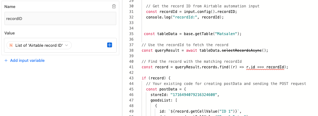

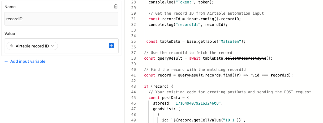

Hi I have an automation script, and run into a problem, it is not fetching the right recordId in the script, but it does in the previous step. Anybody with a larger brain that can se what I have done wrong here?

Thanks @Richard_Quintan
I solved it like this, the problem was it didn't pic the right recordID, but now it works on 1 automation

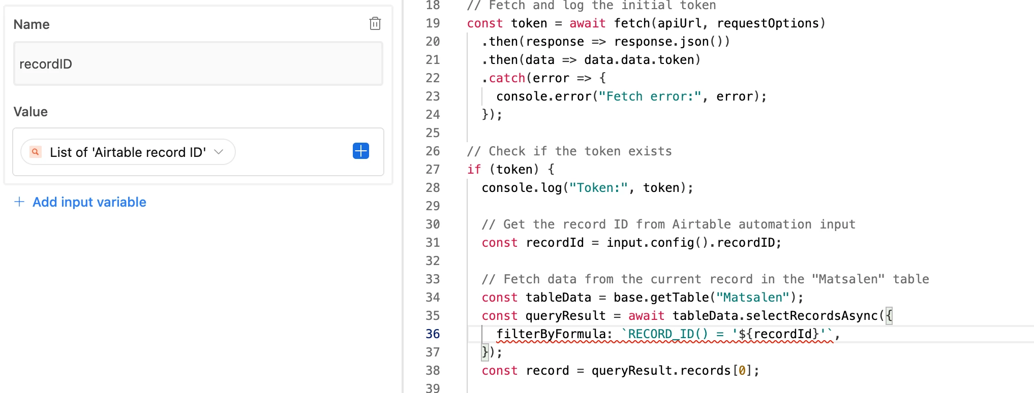

 But I have now a problem when the variable is a "list of AirtableIDs" since its going to be a scheduled automation, but its always just going to be 1 recordID, but in the variable I can't choose just 1. And this code gives me syntax error. Do you know what I need to do in the script when there is a "list" of Airtable IDs but is always just going to be one?
 You see the difference in the variable of the recordID on the left.
Hello there @Jesper_Holmstro and sorry for the delay in responding. As I'm watching, I think that you can't match with the exact ID due to the wrong usage of the function selectRecordsAsync(). In your particular case, you should do something like this
let table = base.getTable("YOUR_TABLE_NAME"); let query = await table.selectRecordsAsync({ fields: ["Field1", "Field2",...,"Fieldn","RecordID"], //you should select all the records you want to retrieve, even the recordID field })
To retrieve the recordID field correctly, you should create a field type formula and then write the formula
RECORD_ID(). With that, you should be able to match the recordID from your input with the recordID in your table.
Let me know if it works for you!
