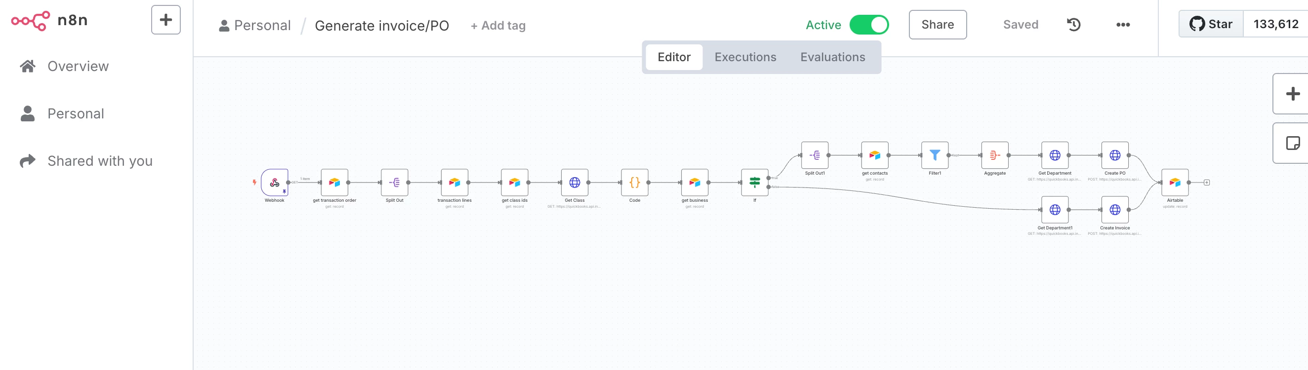

Yes! On my side, I usually use n8n for this implementation (rather than make, mainly for the reasons found here).
It does not seem that you want to have all invoices created in Airtable and only then pushed to QBO. However, if that is the case, you’ll want to really make sure that all data REQUIRED by QBO is actually found on your invoices in Airtable. Otherwise, the system will obviously error and invoices will not get created in QBO. This is important specially if you have multiple people generating invoices in Airtable.
See example of the integration below.
