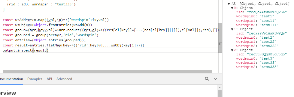

Alexey_Gusev
Forum|alt.badge.img+25
Yesterday I wrote a script to transpose vertical table to horizontal and stuck into object grouping task, which is similar to yours.
After your post I understood that I went wrong way, and how to solve my puzzle ))
So let’s help with yours.
besides grouping, you have other challenge - add new object properties according to those already existing. If wordspin2 property already exists, wordspin3 should be added and so on…
I belieive it has other easier solutions, maybe with spread+destruct, but I would use map array and transform to object.
const wsAdd=x=>x.map((val,ix)=>['wordspin'+ix,val])
const wsObj=x=>Object.fromEntries(wsAdd(x))
group objects by Id is a standard task which have a lot of ways to do.
I took this reducer from net and changed a bit, to add just ‘wordspin’ properties and to get an ‘array of arrays’ on exit
const group=(arr,key,val)=>arr.reduce((res,el)=>((res[el[key]]=[...(res[el[key]]||[]),el[val]]),res),[])
now we need to connect these two ‘data processors’
const grouped = group(array2,'rid','wordspin')
const entries=(Object.entries(grouped));
const result=entries.flatMap(key=>({'rid':key[0],...wsObj(key[1])}))
output.inspect(result)
and here we go !
(if you need to correct numbers near ‘wordspin’ (start from 1 etc) - edit wsAdd function)
