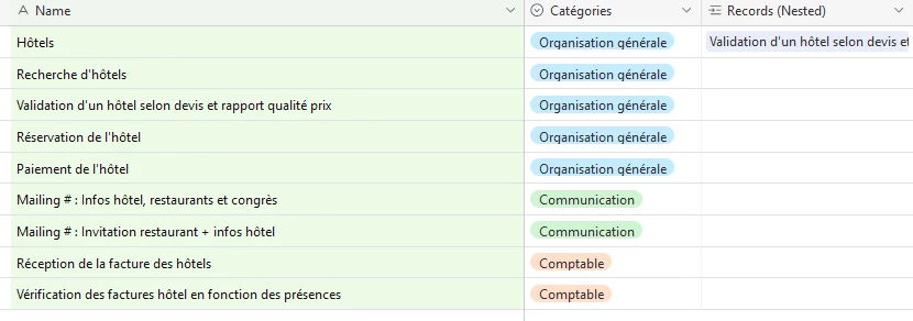

Good morning to you,
I'm trying to create dynamic ToDoLists.
At first, I thought I could solve my problem by using complete NoCode (see my post).
Finally, after some advice, I turned to @Giovanni_Briggs code and post.
I've never coded the day before yesterday, and I'm trying to use AI tools to understand what I'm doing.
I've managed to adapt the proposed code to my base and half of what I want to do works.
As it happens, my code copies the tasks from my original list very well,
It links the new tasks to the event we've validated internally,
But it doesn't create a link between parent and child tasks (I've been tearing my hair out for 24 hours trying to solve this problem).
To explain, each parent task (main task) is linked to several subtasks (child tasks).
example : The Hotel task
is therefore linked to several subtasks:
Hotel search
Validation of a hotel according to quotation and price/quality ratio
Hotel reservation
Hotel payment
Receipt of invoice
When I use my script, everything works fine except for the dependencies part.
Once again, I saw this subject mentioned in Giovanni_Briggs' post.
But my limited knowledge of the subject prevents me from achieving what I want!
Thank you in advance for your time, I don't know what to try to solve my problem!

  • October 6, 2023
Good afternoon,
I'm still trying to get my script to work.
In the meantime, I've added a "Parent Task" column and a "Child Task" column.
Below, my script works for the "Validated congress" automation, which copies my tasks from one table (master table) to another (ToDoLists), and links them to the validated congress. (I've translated the script into English to share it with you).
But there's no link between my tasks, whereas there is in the 1st table.
The automation works, the code is accepted by AirTable, but when I test the script, no link is made between the different tasks.
I've already pulled out half the hairs on my head in frustration, and I'd be enormously grateful if you could help me with this project!
