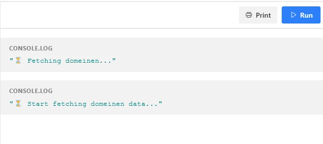

Goal: importing JSON from an open API into my airtable base.
How: Using a script extension in the base (at the bottom of this message), with proper error logging.
Result: No return after “let response;” The script just seems to stop without any error triggering. The last log is “console.log("⏳ Start fetching domeinen data...")”
Test that does work: A curl request to the API does yield the complete JSON, just as a request through postman. So the API is reachable.
The code to request and import the data:
// API credentials let apiKey = "(API key censored, but it's working)"; let apiUrl = "https://opendata.slo.nl/curriculum/api/v1/domein/"; // Function to fetch the domeinen data async function fetchDomeinen() { console.log("⏳ Start fetching domeinen data..."); let response; try { response = await fetch(apiUrl, { method: "GET", headers: { "Accept": "application/json", "Authorization": "Basic " + btoa("key:" + apiKey) // Basic Auth with API key } }); console.log("Response received:", response); // Log the full response object for debugging if (!response.ok) { console.error(`❌ API request failed with status: ${response.status}, ${response.statusText}`); return null; } console.log(`✅ API request completed. Status code: ${response.status}`); } catch (error) { console.error("❌ Error during fetch:", error); return null; } // Check if response contains data try { let data = await response.json(); if (!data || data.length === 0) { console.error("⚠️ No data found in API response."); return null; } console.log("✅ Successfully fetched domeinen data:", data); return data; // Return the domeinen data } catch (error) { console.error("❌ Error parsing JSON:", error); return null; } } // Function to update Airtable with domeinen data async function updateTableWithDomeinen() { console.log("⏳ Fetching domeinen..."); // Fetch domeinen data let domeinen = await fetchDomeinen(); if (!domeinen) { console.log("❌ No domeinen data found. Exiting..."); return; } // Check if the table "Domeinen" exists let domeinenTable; try { domeinenTable = base.getTable("Domeinen"); console.log("✅ Domeinen table found."); } catch (error) { console.error("❌ Error: Domeinen table not found in Airtable. Please check table name.", error); return; } console.log("⏳ Starting to insert domeinen data into Airtable..."); // Loop through each domein and create a record in Airtable for (let domein of domeinen) { // Check if the essential fields are present in the domein object if (!domein.uuid || !domein.titel) { console.error(`❌ Domein missing required fields (UUID or Title). Skipping domein:`, domein); continue; } console.log(`⏳ Inserting domein: UUID = ${domein.uuid}, Title = ${domein.titel}`); try { await domeinenTable.createRecordAsync({ "UUID": domein.uuid || "No UUID", "Naam": domein.titel || "No Title", "Omschrijving": domein.omschrijving || "No Description", "Type domein": domein.type || "No Type", // Adjust according to API response "Release datum": domein.releaseDate ? new Date(domein.releaseDate) : null, // Optional "URL": `https://opendata.slo.nl/curriculum/uuid/${domein.uuid}` }); console.log(`✅ Successfully inserted domein: ${domein.uuid}`); } catch (error) { console.error(`❌ Error inserting domein: ${domein.uuid}`, error); } } console.log("✅ Finished inserting all domeinen."); } // Run the script to update Airtable updateTableWithDomeinen();

Thanks! This works and the script continues and logs an actual error. Now I can find the next issue, which might be unrelated:
console.log
console.log
console.log
console.error
"❌ API request failed with status: 401, Unauthorized"
console.log
