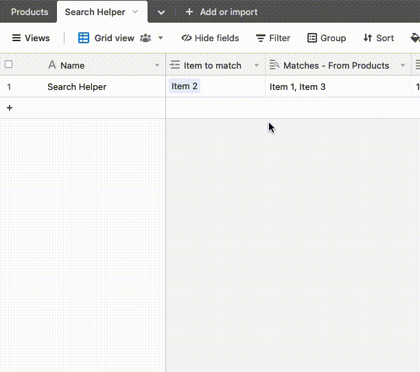

Ah, hmm. I think it’s possible to use an automation for this actually
I would:
  1. Create a new table called Search Helper or something
  2. Create a link between the Products table and Search Helper and call it “Rollup” or something
  3. Link all the records in Products to a single record in Search Helper
  4. Create a new link field between the Products table and Search Helper and call it “Item to match against”
  5. Create lookups in the Products and Search Helper tables to pull the attributes of the product we want to match against through
  6. Use formulas to match the attributes and output the total number of matches in Products
  7. Use a rollup field to find the highest match number in Search Helper
  8. Use a lookup with a conditional based on the previous step to output the highest matching products
The workflow for the sales team would then be:
  1. Go to the Search Helper table
  2. In the Item to match against link field, select the item that’s out of stock that they want to find the next closest thing for
  3. Look at the lookup field mentioned in step 8 above
I’ve put it together here for you to check out and you can duplicate it to see formulas, automations etc
Pros: It’s all automations, so you can make changes yourself
Cons: It’s a pretty intense setup, and involves linking all your Product records to a single record. This might slow down your base, but you generally should be fine unless you’ve got tens of thousands of products?
If you’re using the scripting extension for this, the workflow would pretty much be a button in the Products table that said “Find Matches” or something, and then you’d click it and it’d output a list of the highest matches possible
I can’t really provide much advice for this bit as it’s just code, really. Sorry about that
Pros: No set up (since you’d be paying someone to do it)
Cons: You’d be paying someone to do it heh. And if you ever needed changes you probably would need to pay someone too unless you learned JavaScript yourself
If you’d like to go down the script route, you could hire me to do it! (If you’d rather use the non-script solution I linked above instead and don’t want to set it up yourself you can hire me to do that for you too!)
I would:

Hey @William_Sweet, to view the formulas, you can duplicate the base by clicking the title of the base at the top of the screen, then the three horizontal dots on the right, and then the “Duplicate Base” button
I can also invite you to the base if you’d like; send me a private message with your email and I’ll do that
