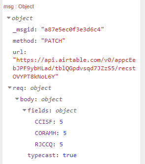

Here is my test JSON:
    "fields": {
        "CCISF": 5,
        "CORAMH": 5,
        "RJCCQ": 5
    "typecast": true
Do I have to include all fields present in the table or only those i wish to update with the PATCH request?

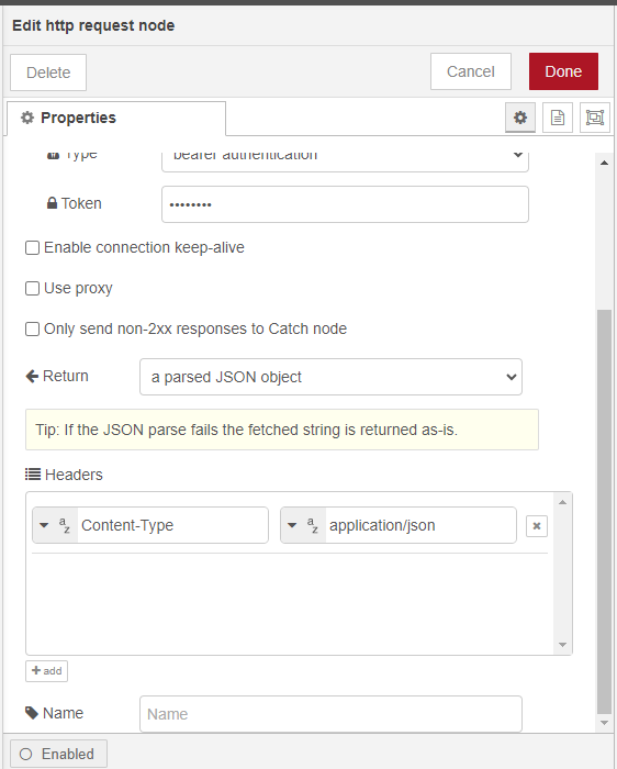

Yes the HTTP Request node as a custom header with Content-Type application/json, see below:

My guess is that I am not sending the JSON to the place the API is looking for it.
I have tried multiple things:
msg.req.body, msg.request.body, msg.body, msg.request, msg.req
The issue is that I don't know where the API is expecting the JSON.
Regards.
  • Feb 29, 2024 8:50 PM UTC
After Further investigations, It appears the request body was sent via msg.payload and not msg.req.body.
I was finally able to do my PATCH resquest.
