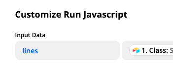

You can do this with a code-step and a for loop.
Where inputData.lines would be as follows:
var lines = inputData.lines.split(',')
Then run a for loop for the length of lines:
 for (var i = 0; i < lines.length; i++) {
***CODE COES HERE******
Thank you @andywingrave! I’ll play around with that. I figured out a solution, but it seems a little inelegant, so I’m going to keep tinkering.
