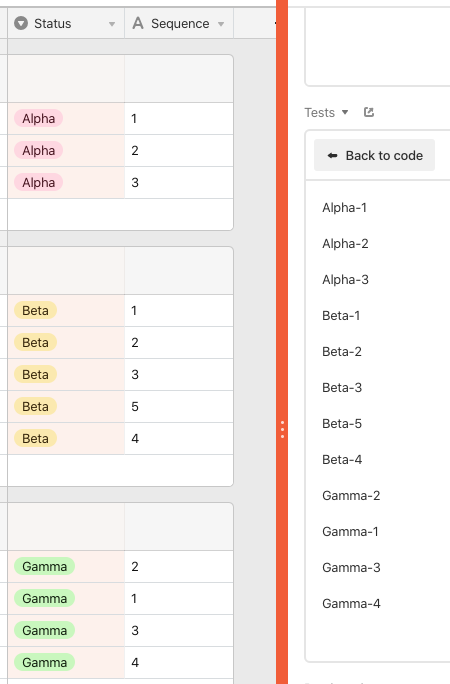

I just ran a test, and the returned records from querying a specific view with grouped records did maintain the group order, including the record order inside each group. Granted it was a small sampling, but I’d like to think that this behavior would extend to larger datasets as well.
  • December 5, 2021
Awesome. Airtable must have quietly fixed.
