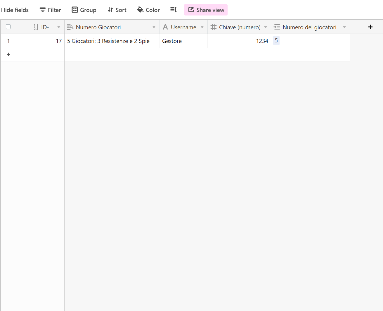

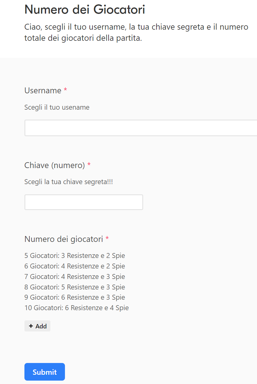

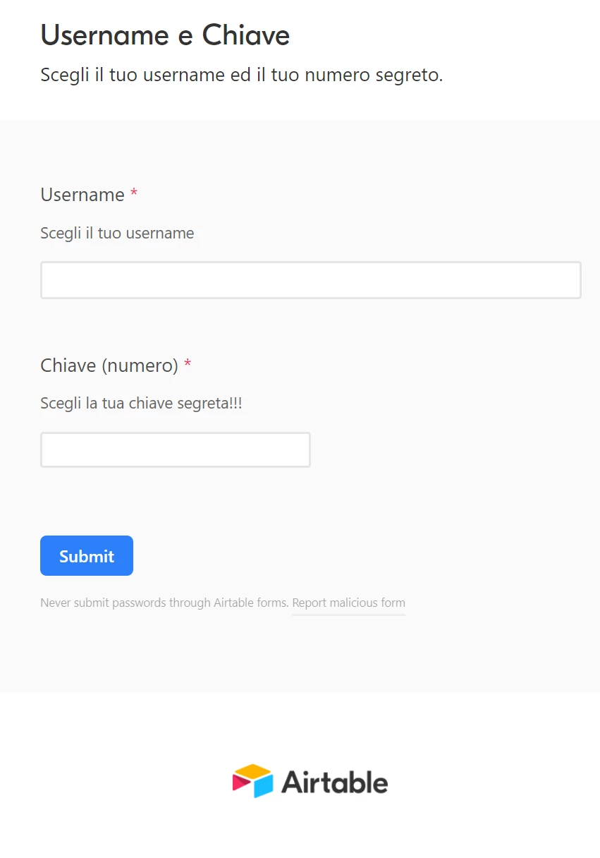

FORM 1
TABLE 1
FORM 2
TABLE 2

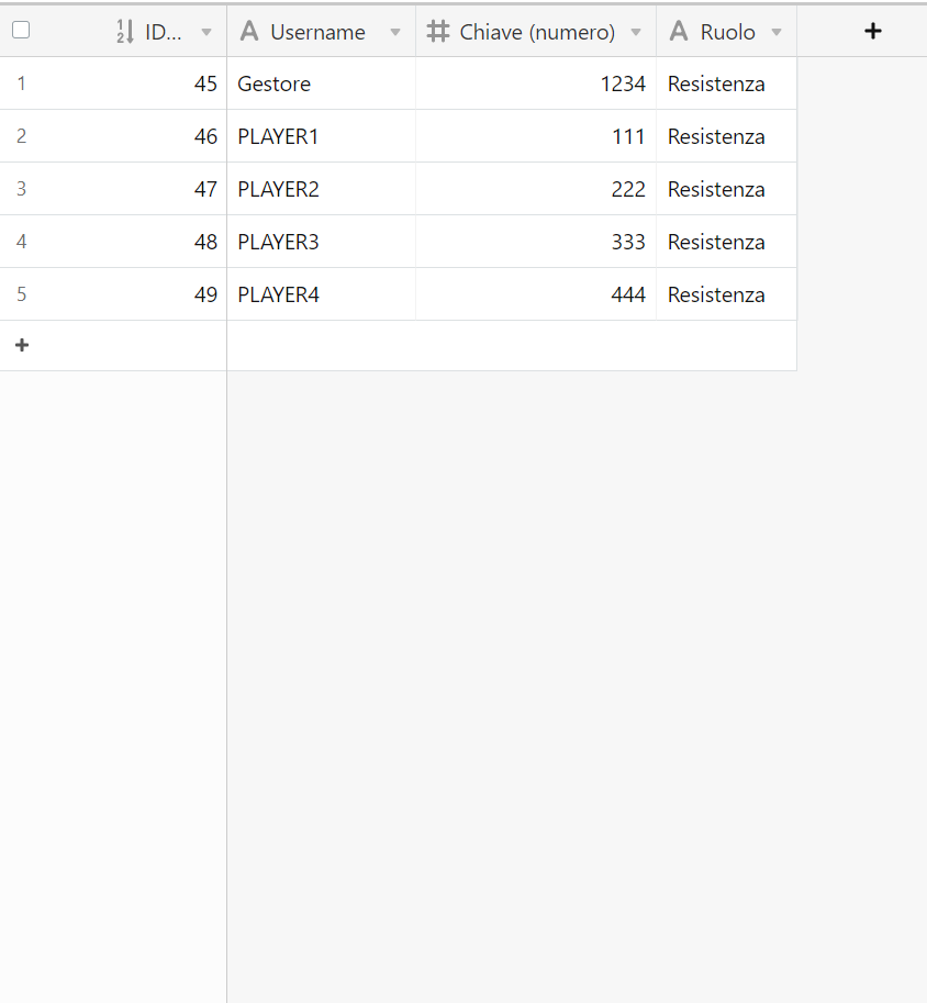

I created an automation to give a value Resistance to the Role column.
I have to write a script that randomly assigns a role for each record, the role can be Resistance or Spy.
The total number of roles depends on the total number of players. The total number of players is found in another table.
If the total number of players is 5 then 3 records must have a Resistance role and the other 2 Spy.
If the total number of players is 6 then 4 records must have a Resistance role and the other 2 Spy.
If the total number of players is 7 then 4 records must have a Resistance role and the other 3 Spy.
If the total number of players is 8 then 5 records must have a Resistance role and the other 3 Spy.
If the total number of players is 9 then 6 records must have a Resistance role and the other 3 Spy.
If the total number of players is 10 then 6 records must have a Resistance role and the other 4 Spy.

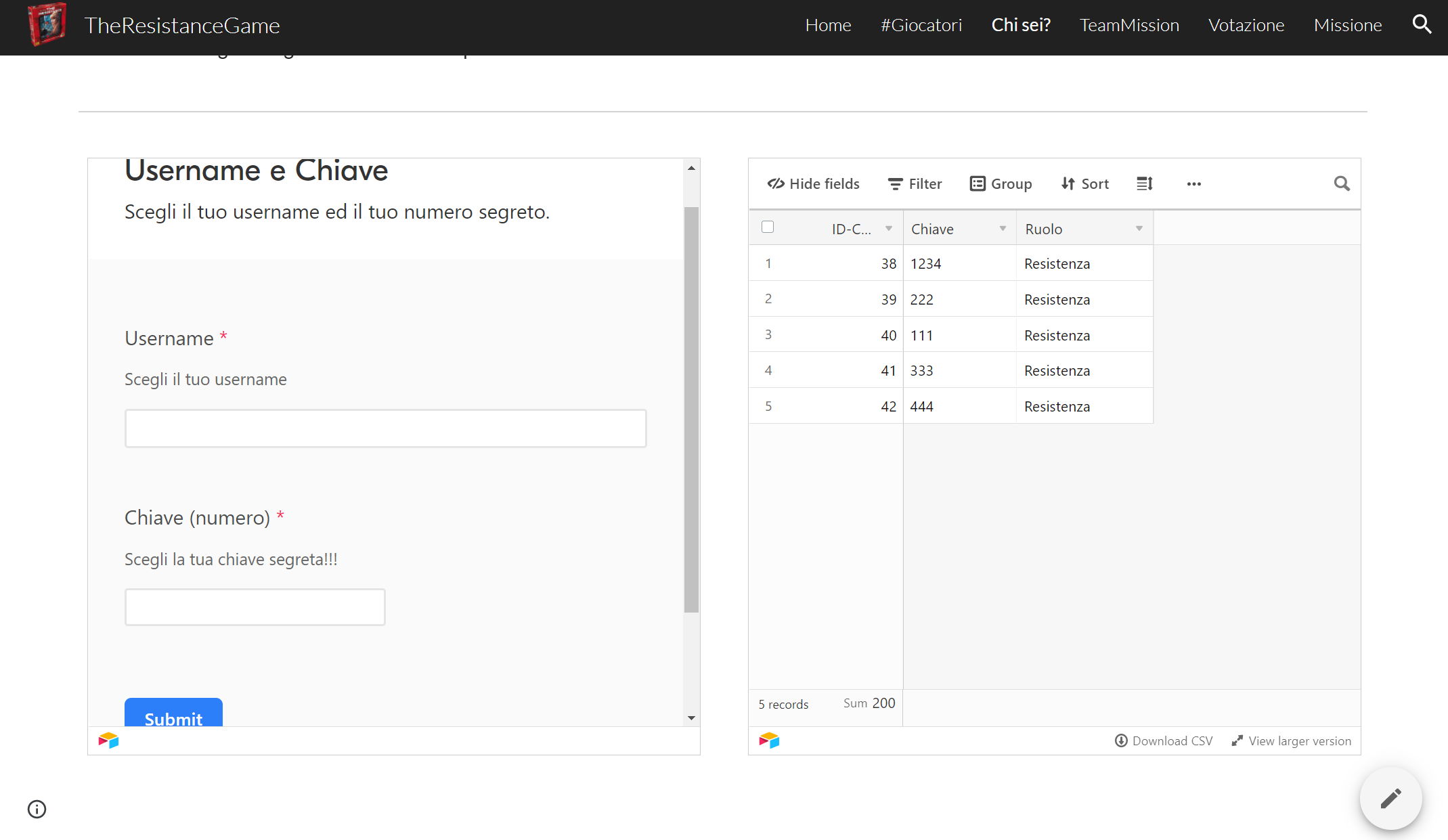

I will be using the tables as frames in a New Google Site where players will go to play the game. Then the game manager will have to click on the “Choose Roles” button when all players are registered in the tables.
NewGoogleSite
Then I will have to solve the problem of how can I keep the New Google Sites updated in real time when the tables on Airtable changes without clicking on refresh button. (Any ideas?)
