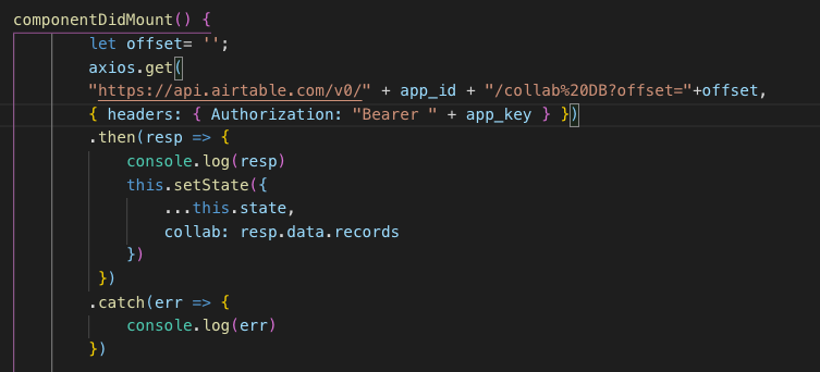

                break;
    } catch (error) {
        console.error(error)
    console.log('fetchCount:', fetchCount);  // print final # records fetched
If there are improvements upon this in any way, whether it is directly related to the Airtable API or with Node (code or structure, async/await), or any other issues, please share.
Output:
fetchCount: 0
fetchCount: 100
fetchCount: 200
fetchCount: 300
fetchCount: 400
fetchCount: 500
fetchCount: 600
fetchCount: 700
fetchCount: 800
fetchCount: 900
fetchCount: 1000
fetchCount: 1024
Indeed, it cannot be an integer mapping to sequential record items because Airtable supports Queries by View and as you know, views can contain all sorts of filtering, ergo, it requires a logical mapping of data, not a numerical mapping.
  • February 26, 2022
why is something like this so complicated…?
  • March 1, 2022
With The official Airtable JavaScript library you can now use all() instead of having to manually paginate:
    const data = await base(tableName)
      .select({ view: viewName })
      .all();
