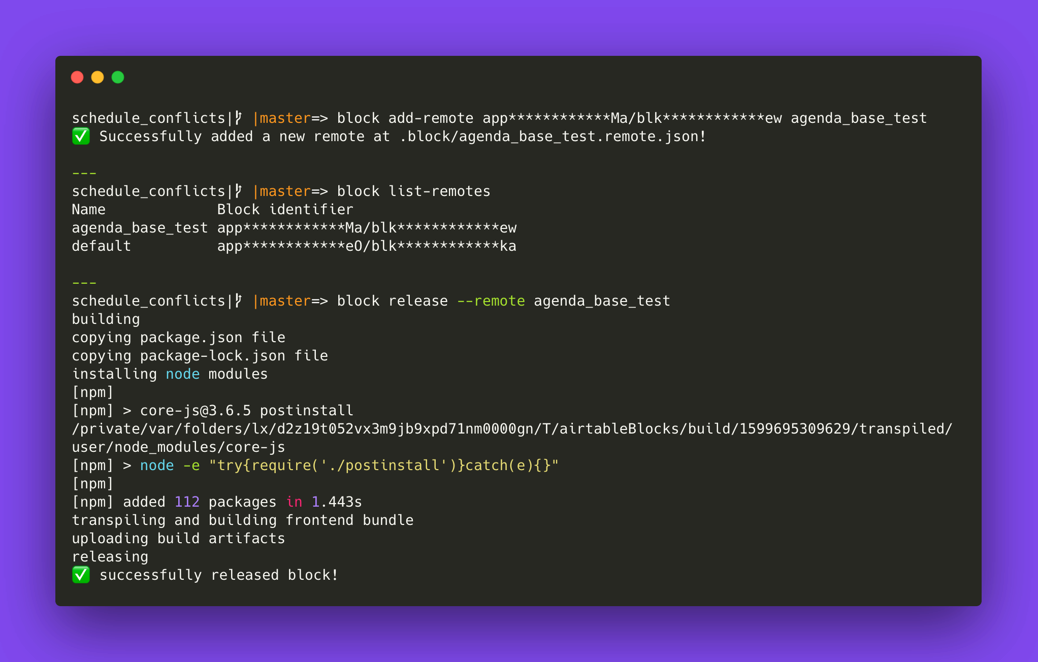

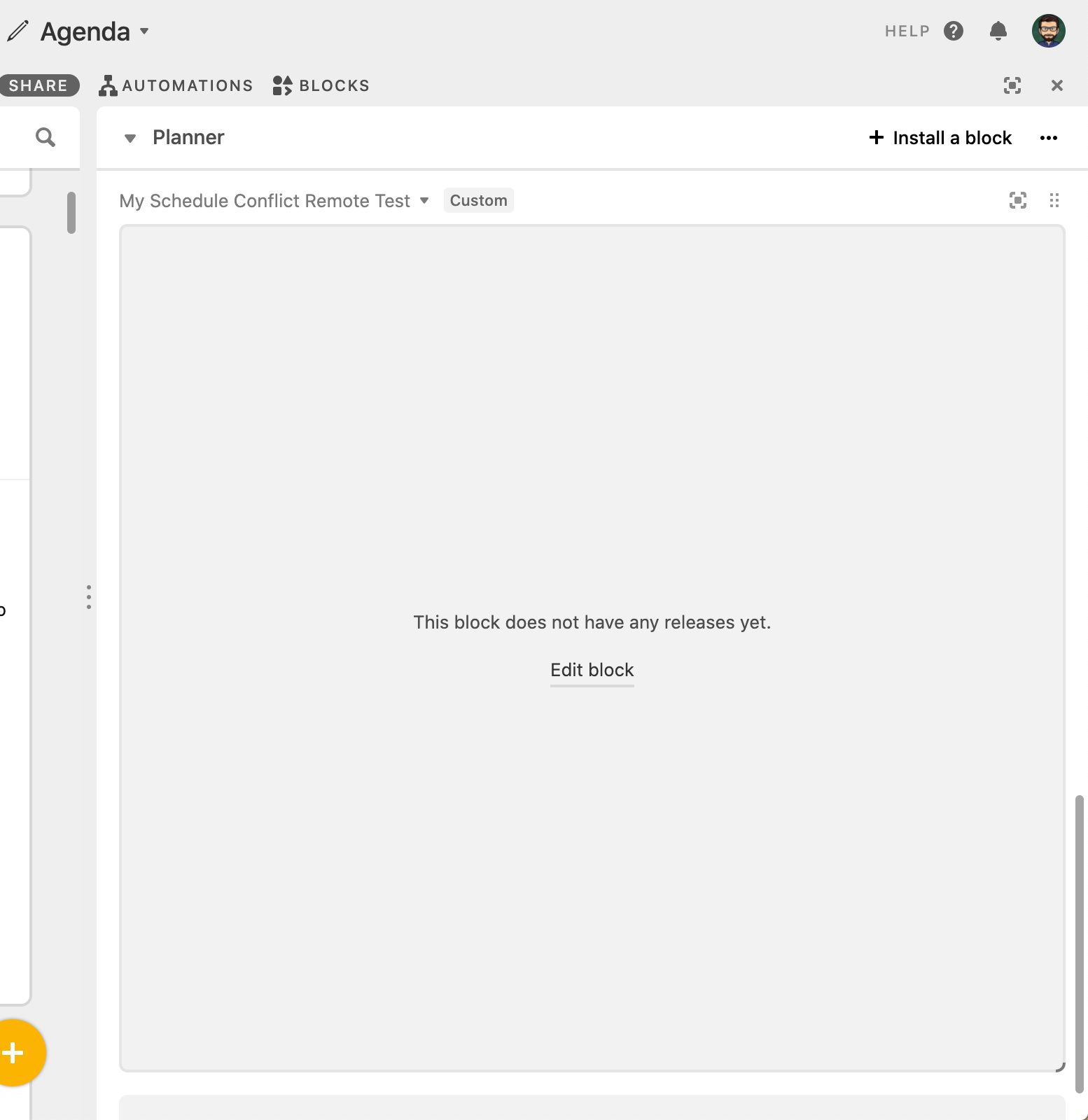

I’m trying to use the --remote feature of the CLI to install my Custom Block into another base, but it doesn’t seem to be working. I’m not sure if I’m doing something incorrectly.
I went through the process of “Install a block”, “Build a custom block”, and saved the appID/blkID, leaving an empty and uninitialized block
Then I ran the CLI commands, with apparently successful results:
But my block remains uninitialized. I’ve tried refreshing multiple times, and I’ve tried running the CLI commands again, and it doesn’t look like it’s done anything.

@Jeremy_Oglesby double checking, are the asterisks in the app***/blk*** screenshot added by you? (The actual block list-remotes command should not redact the ids).
To help debug, could you please check/share these things:
  • Version of the CLI you are using
  • On your custom block installation in the new base, click the name, “Edit block”, “How do I run blocks locally”, “Continue”, and check the app.../blk... shown in step 2 matches the content of .block/agenda_base_test.remote.json
  • Check whether block run --remote agenda_base_test works and allows you to run the block in that installation
  • Check the other block dashboards in your new base to double check the remote corresponds to the installation you are looking at (vs updating a different block in your base)

Thank you so much for the quick response, @Emma_Yeap.
Yes, I redacted the ID’s myself for the screenshot - they list fully when I run $ block list-remotes.
And it turns out I had the wrong appID/blkID… Thank you for that instruction on how to retrieve them.
Using the correct appID/blkID worked.
And now I’m left scratching my head as to where I got the incorrect appID/blkID from… I only installed and copied the ID of one block, that I can remember :confounded: . I must be getting old…
