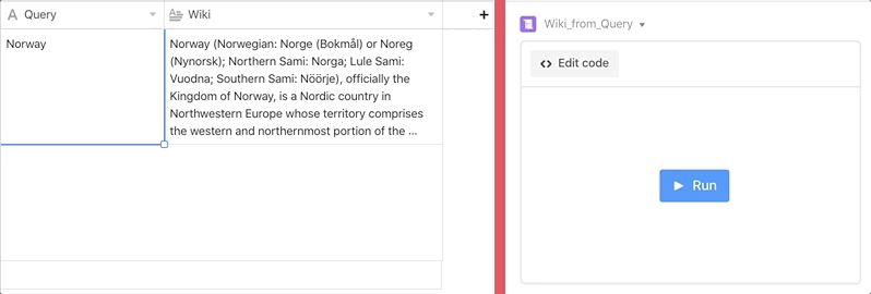

[ETA: I used remoteFetchAsync both in my code and edited the sample code as well. I also confirmed that the characters look fine if I just do my call in the browser…]
I seem to be having the same issue BUT I also tried this shared code example and it works successfully e.g. pulling https://en.wikipedia.org/wiki/Åland_Islands:
The (non-public) API I am working with has the exact same code but the accented characters are not coming through properly (“name: “Ã…land Islands””)
I am trying to follow up and see if there is something different I need to account for in how the API I am using delivers content…
HTH
Update: so the only work-around I have found is to move the script to an Automation where I can use fetch instead of remoteFetchAsync
Cannot figure out why didn’t doesn’t work for my API but does work for e.g. Wikipedia.
