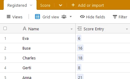

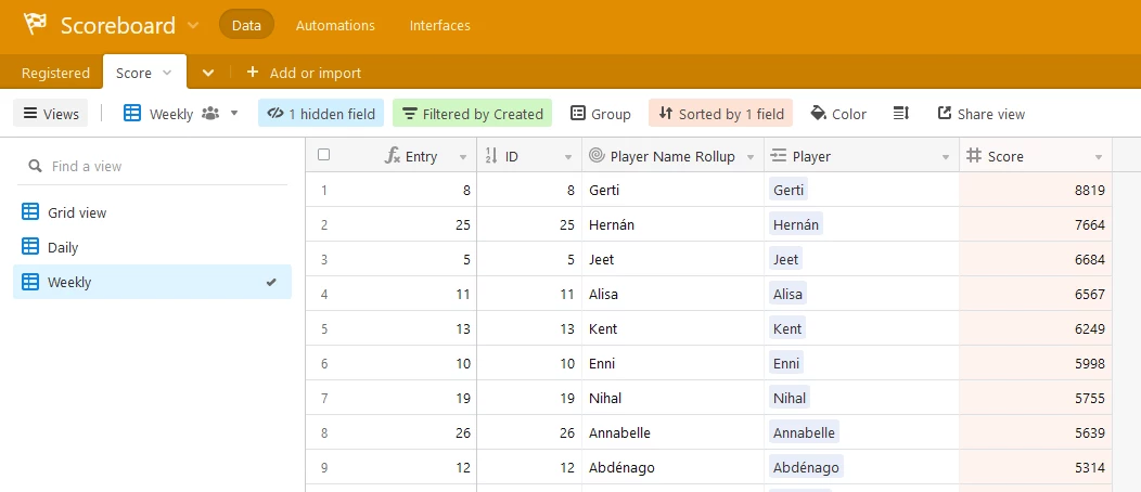

Simple two table base layout - an active score board;
And registered users;

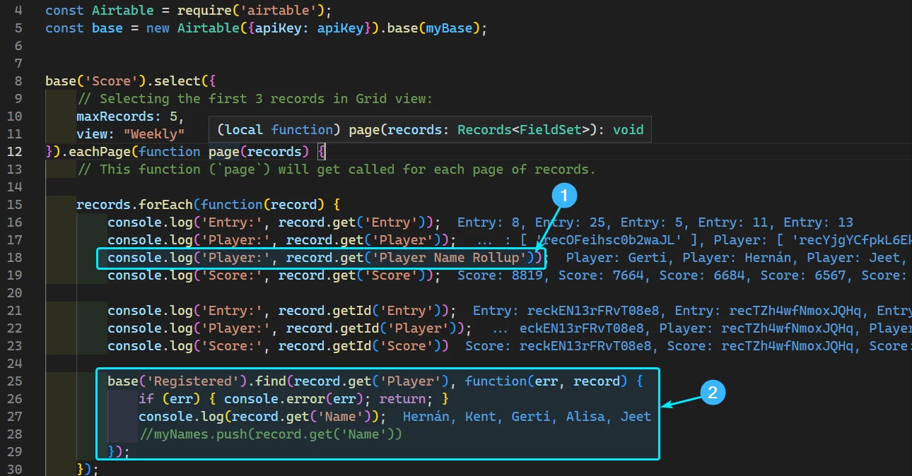

My example code below, heavily influenced by the current Airtable API code samples - when retrieving the ScoreBoard, how best to show the Linked User names?
Although I’m yet to refine my find() code block, already I can see that returned names aren’t in any particular order, as opposed to the Player Name Rollup at least being the correct order.
So in summary, do you tend to code solutions in the base, or solutions in the API source when working with Linked Records? I can see advantages of knowing and understanding both.

const Airtable = require('airtable');
const base = new Airtable({apiKey: apiKey}).base(myBase);
base('Score').select({
    // Selecting the first 3 records in Grid view:
    maxRecords: 5,
    view: "Weekly"
}).eachPage(function page(records) {
    // This function (`page`) will get called for each page of records.
    records.forEach(function(record) {
        console.log('Entry:', record.get('Entry'));
        console.log('Player:', record.get('Player'));
        console.log('Player:', record.get('Player Name Rollup'));
        console.log('Score:', record.get('Score'));
        console.log('Entry:', record.getId('Entry'));
        console.log('Player:', record.getId('Player'));
        console.log('Score:', record.getId('Score'))
        base('Registered').find(record.get('Player'), function(err, record) {
            if (err) { console.error(err); return; }
            console.log(record.get('Name'));
            //myNames.push(record.get('Name'))
}, function done(err) {

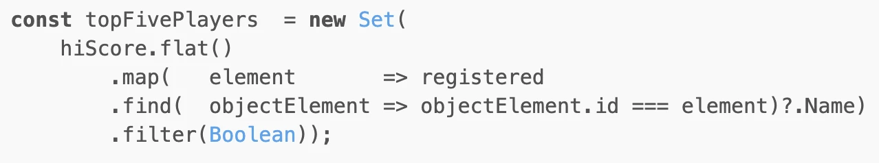

const topFivePlayers  = new Set(
    hiScore.flat()
        .map(   element       => registered
        .find(  objectElement => objectElement.id === element)?.Name)
        .filter(Boolean));
console.log(Array.from(topFivePlayers))
I’m keen to hear your feedback, as I’m interested to know if I’ve coded anything back-to-front, or in a legacy manner.

Congrats! This looks like it has been a great learning project. Your output should tell you if you’ve solved it or not. If you aren’t sure, having a few different test cases should help you be sure.
But keep in mind that there are multiple possible solutions, so if your goal is learning (versus simply having working code), you can always code both options you were considering at first and compare the results and the code required. Or keep refactoring to see what else you can learn.
Here are some random thoughts that came to my mind when reading your code.
  • why the try catch that just logs the error? If the first try/catch fails, why not quit since you won’t be able to do the later tasks.
  • I’m a little surprised by the .push and wonder why you decided on it. What were you doing before? Were you having trouble with variable scope? I would expect to have the variable declaration before the try/catch and simple variable assignment inside the try/catch.
  • why create a set from your hiScore array? Are you getting rid of repeats?
  • your arrangement of white space in the array functions inside the creation of the set make the code hard to read
  • Bill will probably tell you to create a hash of record ID to player name to avoid nested looping
  • why are you filtering on the keyword Boolean?

We do know he only wants names in the top five slots. So he needs at most to convert five record IDs to names.
We also know that he is retrieving at most 100 names, although that might not be his intention.
So at this scale it probably doesn’t really matter.
But I get the impression that this is also a learning project, so it might make sense to learn techniques that do scale, even if not strictly necessary.
As for removing duplicates, it would be more efficient to remove duplicates before converting record ids to names. Again it doesn’t matter at this scale, but it is something to think about from a learning point of view. Then again, maybe thinking about scaling is too much for this stage of learning.
I believe all the sorting is done in the view settings. So there should not need to be any sorting done at all in this code.
That bit of code is him matching record ids from a linked record field with names from the linked table. He is trying to take your advice about not using the rollup field.
If he did take advantage of the names in the rollup field the code would be much simpler. Query for the first five records in the sorted view, specifying that you only want data from the rolled up name field. Then map the records to the field value and make unique.
I would caution that the process of making the values unique does not necessarily preserve the desired order of the top five. It probably will, but technically elements in a set are not ordered and so there is no guarantee that the order of the array that is generated from the set is in the same order as the array that was made to create the set.

That is probably because the use of white space makes it hard to read the code, which I also pointed out.
This particular bit of code could be revisited for various reasons. It reminds me of when I was teaching paragraph and essay writing when my kids were in upper elementary and middle school. There are various things that can be cleaned up but it is hard to say what to do because some changes negate the need for others.
And really getting working code at all is sometimes such a triumph that it needs to be celebrated without nitpicking on other things.
On the other hand, if this is truly mostly a learning project. I would put understanding how to use white space for readability as far higher in importance than learning scaling tricks. Having readable code is a fundamental skill that makes everything else easier. Imagine trying to edit an essay in messy handwriting versus one written in MLA format. Fix the handwriting first so you don’t have to waste time figuring out what you wrote versus being able to focus on the actual content. There also isn’t only one readable style—there are many.

Why the try catch that just logs the error? If the first try/catch fails, why not quit since you won’t be able to do the later tasks.
At this stage in my project I haven’t needed much focus on error handling. What you’ve mentioned here will be ideal to implement soon-ish.
I decided on this because I couldn’t get a simpler method to work. :cry: This is where I lost most my time, trying to understand the various methods available to pull data from to tables, and then intertwine them (in my case, matching an object of Names and Ids to an Array of Ids) to get the desired result.
Yes. The aim here is to remove duplicates as the same player may get into the top 5 players more than once. I now realise too that to guarantee the return of the top 5 players, I need to pull the top 21 players down - then de-dupe, then return an array of 5.
Yes, I found this too. Admitingly my code is a mish-mash of what I found through reading online, and what I then worked into the code.
This cleans out any nullish data from the final array, it’s probably not needed, but will keep for now.
Yup, I have decided that the base will exist without supporting fields, and that I’m to learn to solve this problem with code outside of my base. (I too manage a base professionally, and the idea of loading in Rollup fields for every lookup/linked field in that base struck fear into my heart :rofl: ).
It’s important to note that although my code works in VS Code (yay!), as I started to transfer it into my Node JS server, it returned this error.

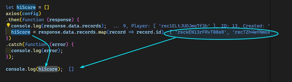

It’s worth noting this mornings direction, learning Axios. Already I’m making a lot more sense of my code - but am getting stuck with getting my response data where it needs to be.
 SyntaxError: await is only valid in async functions and the top level bodies of modules
I won’t troubleshoot this yet, not until I’ve revised/rewritten aspects and have an understanding of them.

Ah the wonders of asynchronous code.That’s a whole can of worms in and of itself.
This is also related to the idea of asynchronous code. Your final console.log(highScore) is executing before the code in the .then. That is why it has the old value. Try adding another console.log immediately after you set the value of hiScore to see what I mean. Also add a console.log that shows the timestamp and some static text so you know which line was executed…
