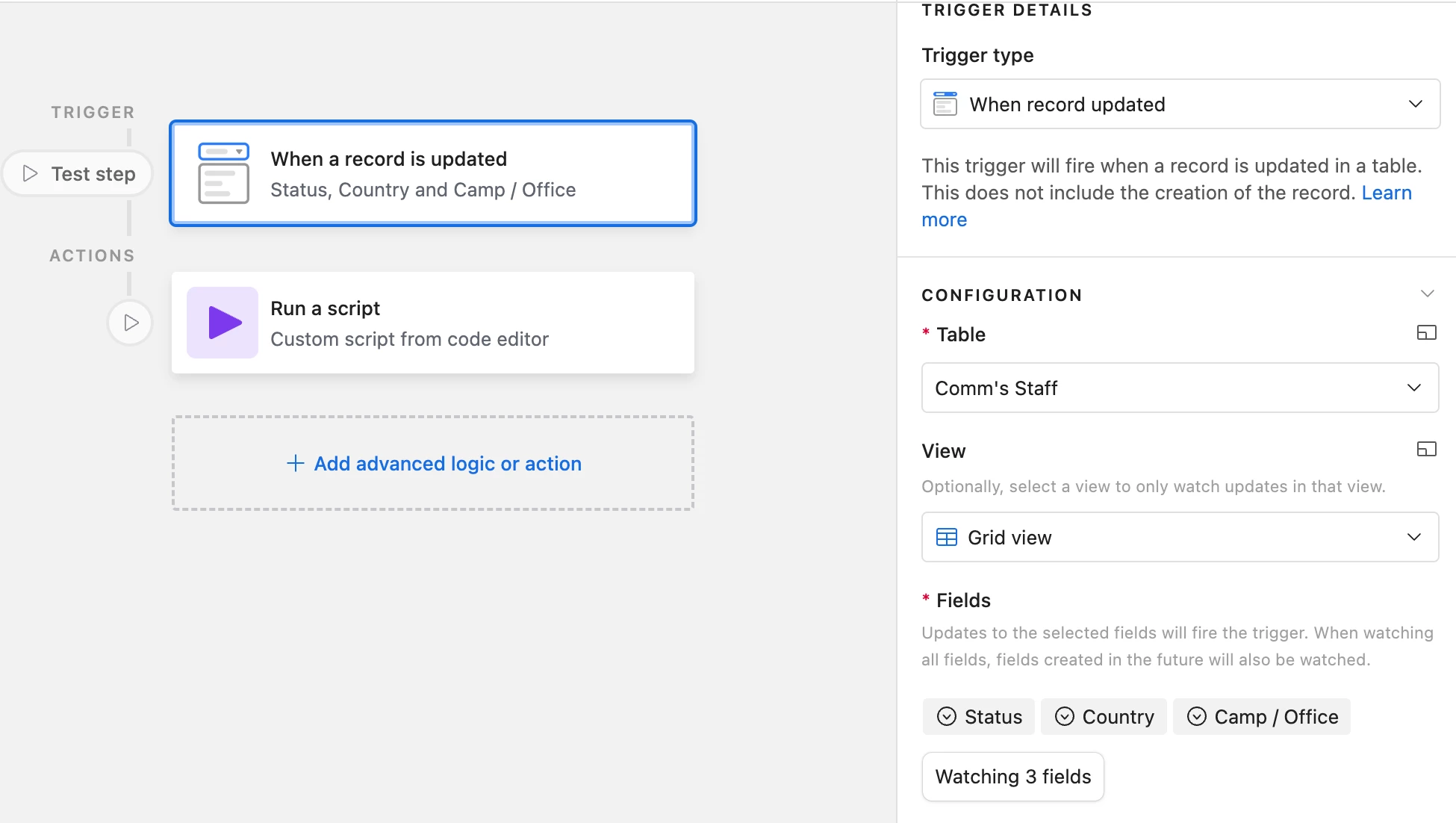

Hi, I'm running an automation that monitors a table for certain fields and when any of those fields get updated, I want to run script that sends those field values to an external platform, via an API call to that platform. I know how to write this script, however I can't figure out how to reference the specific record whose field was updated. Is this possible?
Here is a screenshot of my automation.
Try adding the record ID as an input variable like so:
Yes, you need to specify the triggering record ID as a variable in the input.config.

to avoid querying the record by RecordID, you can just add those 3 values to a left side
and then
const {status,country,camp_office}=input.config()
note that variable names in code must match variable names you set in the left side.
you can also avoid hardcoding and simply pass all available data from left side, cloning input.config() and possibly add some data to it. of course, it depends on platform API requirements
