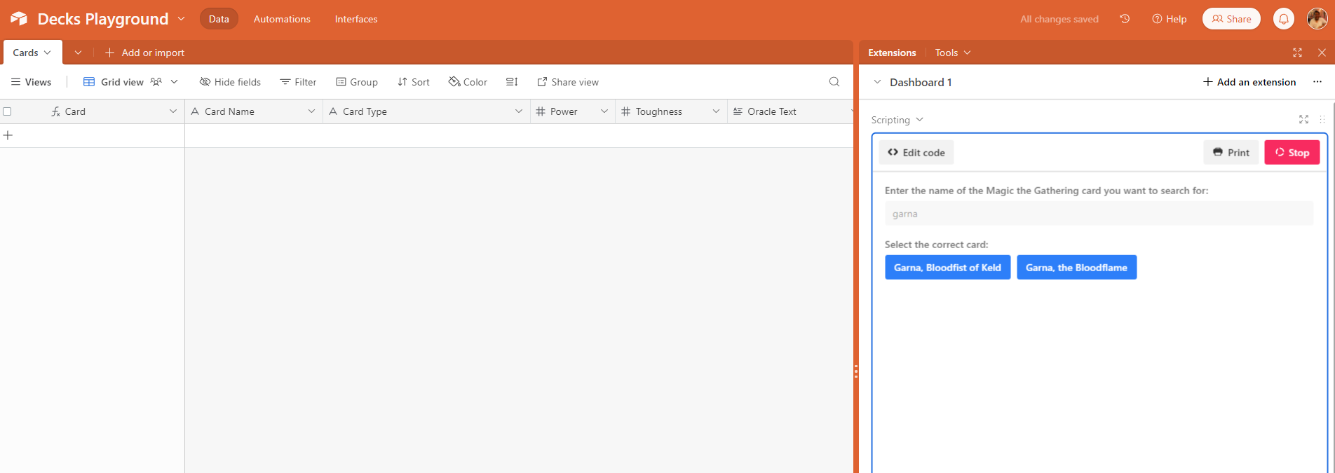

This is a code that uses the Scryfall API to search for Magic the Gathering cards based on user input. The first line prompts the user to enter the name of the card they want to search for. The second line sends a request to the Scryfall API with the user's query, and the third line converts the response to JSON format.
The code then checks if the API returned any search results. If there are no results, the code outputs "No results found." If there is only one result, the code creates a new record in a table called "Cards" in a service like Airtable with the card's information, and outputs a confirmation message. If there are multiple results, the code prompts the user to select the correct card from a list, and then creates a new record for that card in the "Cards" table.
The issue arises when after the list of potential cards is loaded as search results, if it cant parse the card name it gives a bunch of options, no matter what option you choose, it wont actually add the choice as a record. What could I do to modify it to add the card as a record?

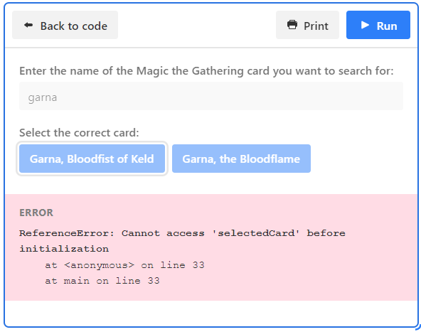

@Ben_Young1 Thanks for the quick reply! I'm working on it more so down the line it will be able to increase the quantity of a card if its already been added, I'll definitely check into using the card id as a way to improve it even further! I am testing out the provide code you sent me and I'm running into one error, on line 33 I am getting an error regarding the selected card!

Whoops - Misnamed a variable lol.
I just updated the script in my snippet found in the original post.
Try that snippet.

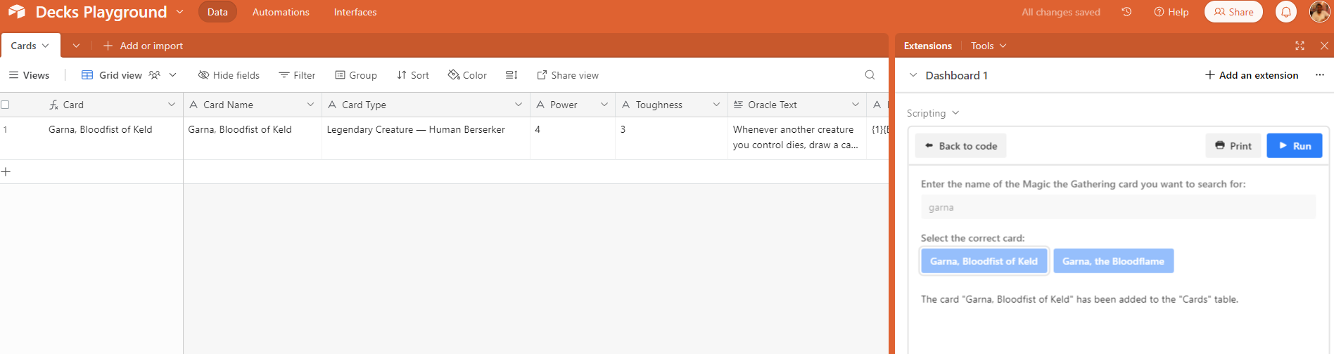

  • February 17, 2023
Try that snippet.
@Ben_Young1 Worked like a charm, thanks! Once I improve and expand on it I'll be sure to show it to you, thanks so much for your help!
