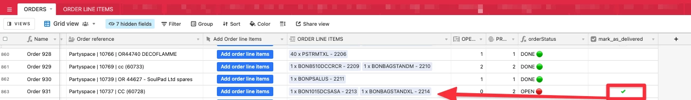

Below, I provide some screenshots to visualize my base layout.
At this moment, I’ve updated the script with your suggestion. The script runs and doesn’t return an error. However, the single select field in the order line items table remains unchanged.
Kind regards
