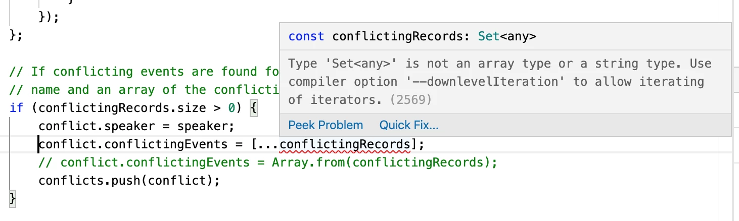

In the Scripting Block’s editor, when I try to use the spread operator [...] to spread a Set() into an array, I get syntax highlighting for an error:
Using Array.from() on the same Set() works just fine (no syntax highlighting). But, curiously, the Scripting Block also runs the script just fine with the Spread operator version of that line of code, even though it’s highlighted as an error.

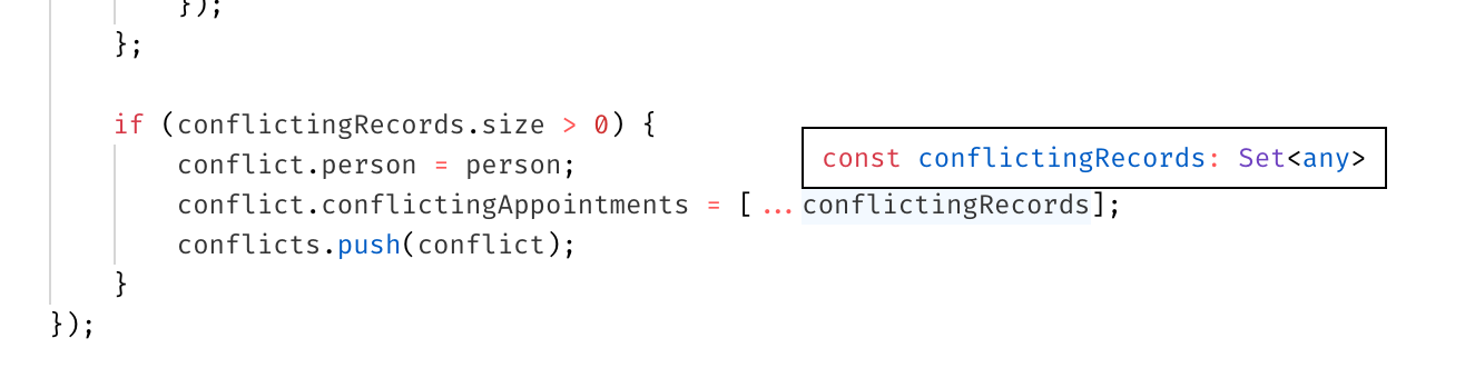

The same code does not produce any error highlighting in a JavaScript environment in VS Code:

Thanks for the report – this is not intentional. Using the spread operator should be fine. We will remove the warning.

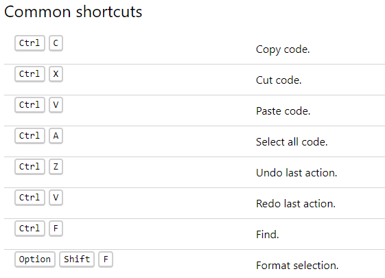

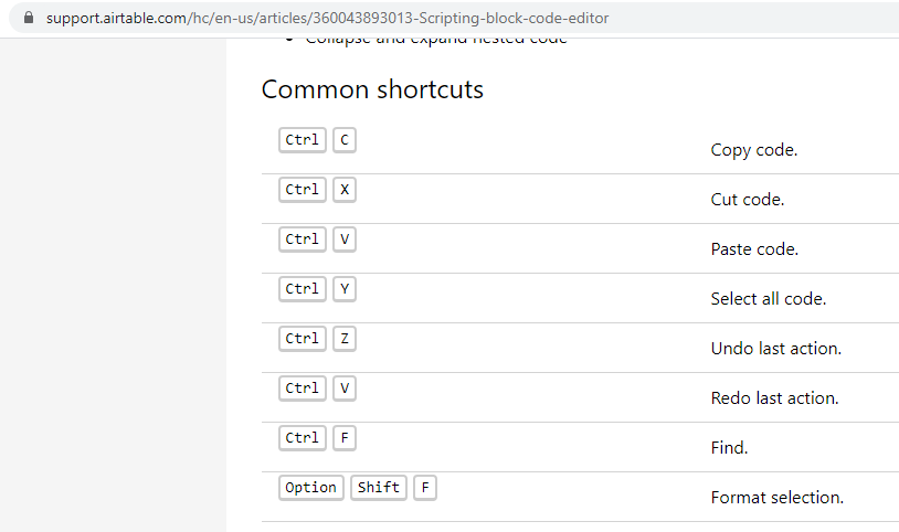

Thank you for letting us know more about the scripting block editor. I am accustomed to a different editor and my transition to this editor has been rough.
By the way, I am having some trouble with the editor. For me, the keyboard shortcuts for select all code and Undo last action do no work as documented on the support website in the screenshot below. (Ctrl+V also has two documented actions, but for me it only does the first.)

Thanks for flagging this! These appear to be errors in our support documentation — we’ll get those fixed ASAP.
On Windows:
  • Ctrl + A - Select all code
  • Ctrl + Y - Redo last action
On Mac:
  • Cmd + A - Select all code
  • Shift + Cmd + Z - Redo last action
On Windows:
On Mac:
:thumbs_up:
At least some of the errors are already corrected!
But there are still errors. Maybe you are still in the process of making the corrections, but I thought I’d post in case some of them still slipped by.
(By the way, I mean there are still documentation errors because the documentation does not match what you described as the expected behavior in this thread. For me there are still non-documentation errors because my editor does not behave as you described in this thread.)
