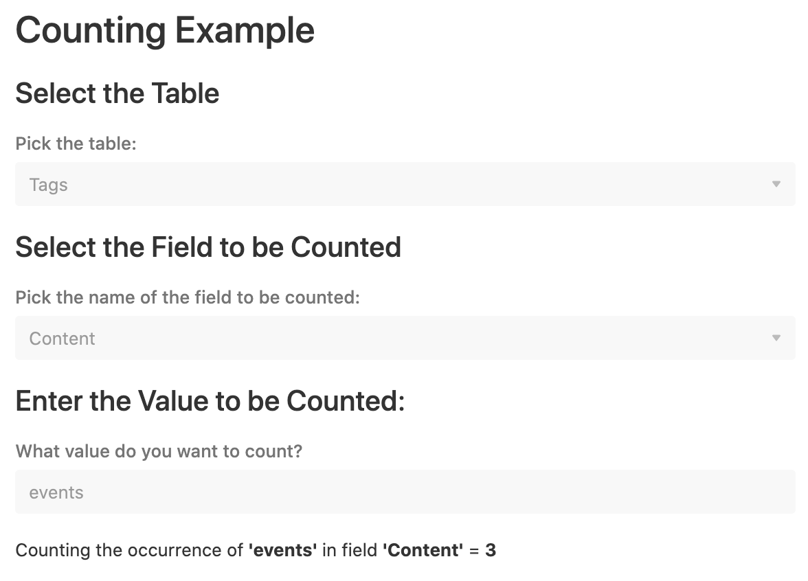

Here’s a start … it’s a block that lets you determine the occurrence of a given string in a text field for all records in the selected table.
Source Code
   Airdrop - Counting Example
   Copyright (c) 2020 by Global Technologies Corporation
   ALL RIGHTS RESERVED
output.markdown('# Counting Example');
// get the table name
output.markdown("### Select the Table");
let sourceTable     = await input.tableAsync("Pick the table:");
let sourceTableName = sourceTable.name;
// get the source field name
output.markdown("### Select the Field to be Counted");
let sourceField = await input.fieldAsync("Pick the name of the field to be counted:", sourceTable.id);
let sourceFieldName = sourceField.name;
// set the value to be counted
output.markdown("### Enter the Value to be Counted:");
let thisQueryValue = await input.textAsync('What value do you want to count?');
// get the records
let result = await sourceTable.selectRecordsAsync();
let sourceRecords = result.records;
// iterate across all the records
let thisCount = 0;
let thisFieldValue;
for (var r = 0; r < sourceRecords.length; r++)
    // get the field value for this record
    thisFieldValue = sourceRecords[r].getCellValue(sourceFieldName);
    if (thisFieldValue != null) {
        if (thisFieldValue.toString().toLowerCase().includes(thisQueryValue.toString().toLowerCase()))
            thisCount += 1;
// display the count
output.markdown("Counting the occurrence of **'" + thisQueryValue + "'** in field **'" + sourceFieldName + "'** = **" + thisCount + "**");

@Bill.French - Thank you for the advice! Definitely, a great start!
