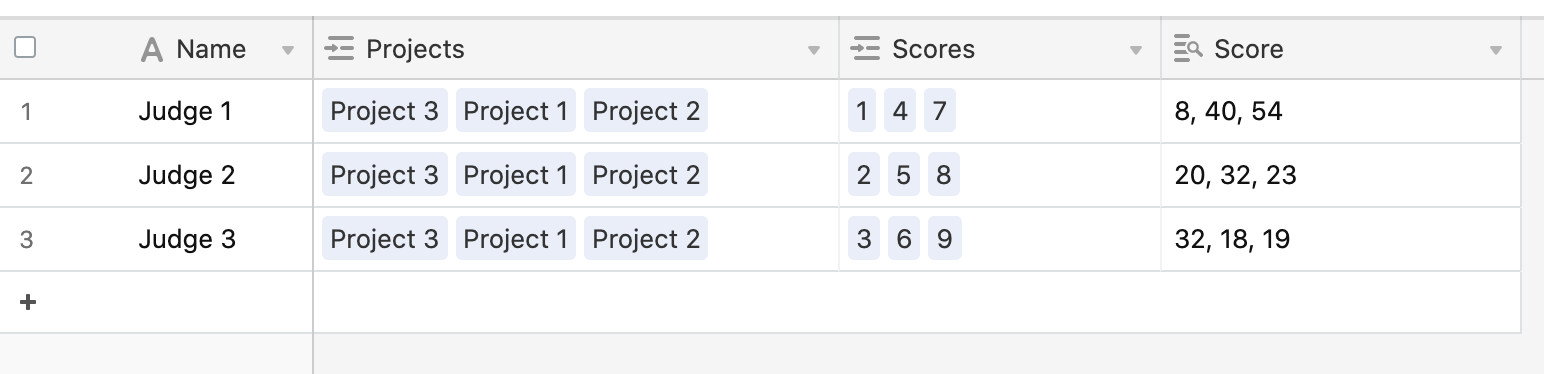

So, with a table like this:
you want to calc the STD of the “Scores” field for each Judge, right?

If your table is like mine, the array of values returned from the “Scores” field is an array of strings:
["8", "40", "54"]
So I’ve mapped that to an array of numbers which we can then do the STD on.
