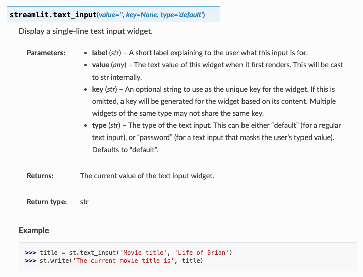

I’ll take a stab at what @Olpy_Acaflon may be intimating. If I’ve misjudged @Olpy_Acaflo’s intent, I have simply shared another related but equally important shortcoming. :winking_face:
The Script Block has definitive ways to surface UI components that are neither native HTML nor traditional DOM methodologies. This makes sense [actually] given the need to sanitize code running on joint-tenant SaaS services.
The constraint, however, is that there’s no way to set a default value for a UI component such as input.textAsync (i.e., defTable passed here as a default value parameter isn’t supported it seems):
// select the table
let defTable = "Sales Transactions";
let srcTable = await input.textAsync('Enter the table name:', defTable);
This may come as a surprise to many developers since it’s a common expectation that any type of input operation also accompanies ways to visibly establish default values for users. Streamlit (the data science platform) for example addresses this requirement quite elegantly.
