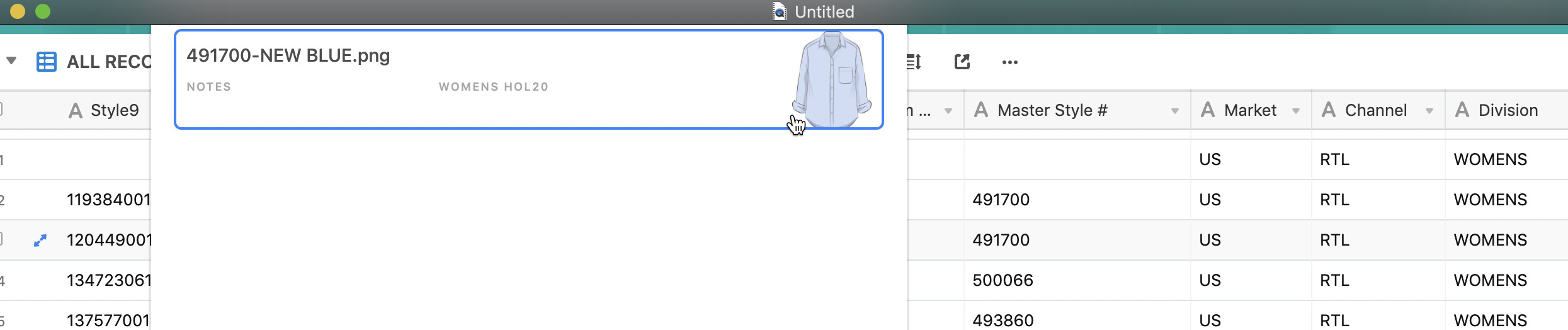

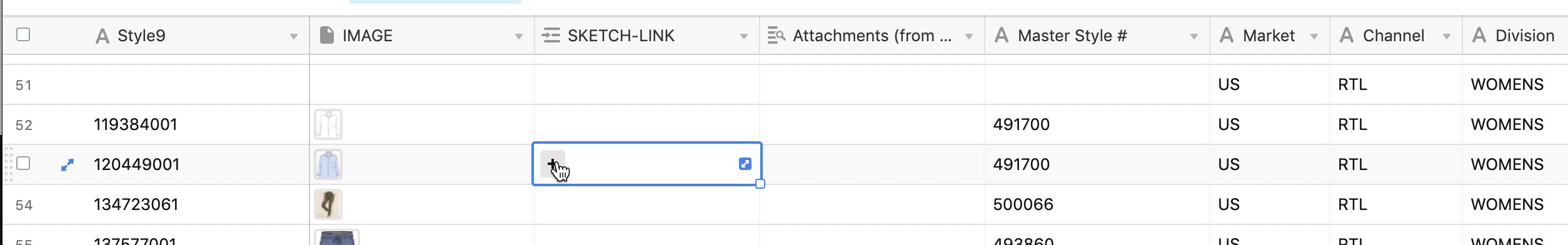

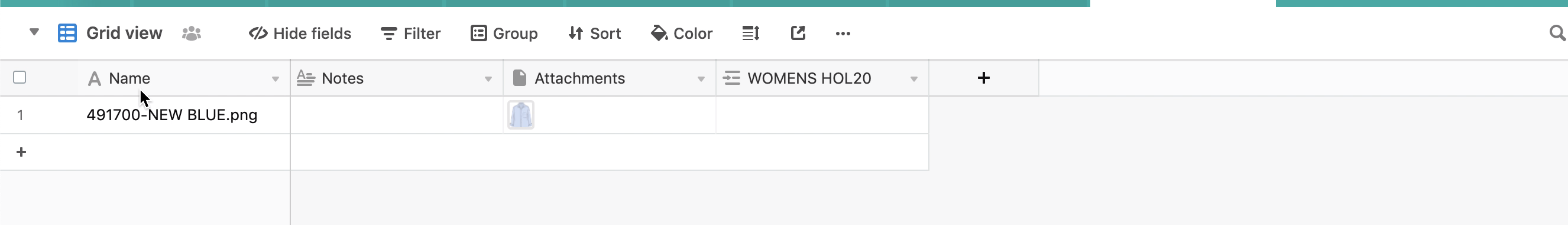

I am doing something similar but was planning to first use the gallery view bulk upload (purple X) that gives the option to create a record for each image rather than hosing elsewhere. The gallery attachment upload uses the filename as the primary field. My quandary is how to do what @hgld is asking I think - how then to match to a field name in a separate table, link and attach these images to their corresponding field name. Here are screenshots from a screencast showing how I am doing it manually with linked record. But I have 5,000 sketches I have to match up.
