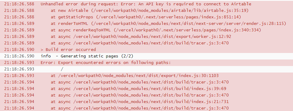

even when I’m running the app locally, I am getting error 401 that the airtable API key is invalid. If I print the process.env.API_KEY it is totally fine so the .env does work.
When I copy the same key and paste it into the code, everything works fine!! It seems like Airtable has a strange problem, maybe with next js or something because I can’t get this to work in any way.
I really need to deploy my app and can’t do that without hiding the key in .env/next.config.js…can anyone help on the matter?
deployment error pic
Thanks!

Hey @Digital_Bo
Check out where the error is coming from in the AirtableJS SDK:
That’s a pretty solid hint that process.env.API_KEY is undefined during the build process. Are you certain that Next will have loaded your .env before executing that function?
