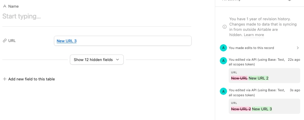

Hm, as a data point, I just did an API call to update a URL field via Postman and it worked fine.  Here's the Postman script:
const myHeaders = new Headers(); myHeaders.append("Content-Type", "application/json"); myHeaders.append("Authorization", "Bearer [YOUR_API_KEY]"); const raw = JSON.stringify({ "fields": { "URL": "New URL" } }); const requestOptions = { method: "PATCH", headers: myHeaders, body: raw, redirect: "follow" }; fetch("https://api.airtable.com/v0/APPID/TABLEID/RECORDID", requestOptions) .then((response) => response.text()) .then((result) => console.log(result)) .catch((error) => console.error(error));
