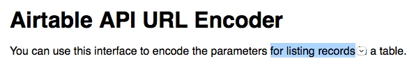

That codepen won’t work for POST requests - it is only capable of making GET requests, and only for the purpose of “listing” existing records, as it states under the heading:

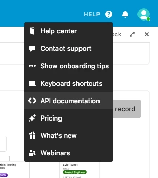

If you click on the “HELP” button in the upper right-hand corner of the base you want to post to, one of the options is “API documentation”:

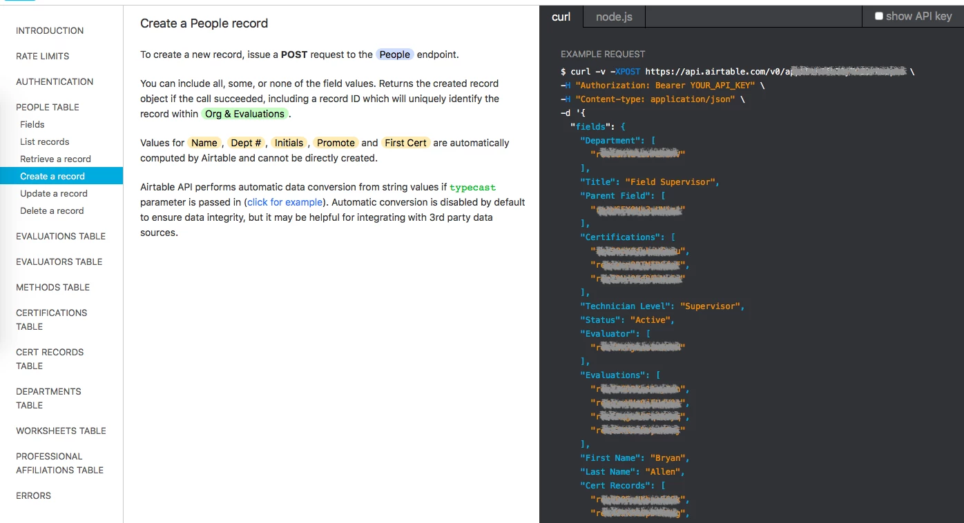

That documentation can show you how to make a command line URL POST request
But when you POST to a table, the data you post has to be formatted as json, so it’s a bit more complicated than just a simple URL string.
