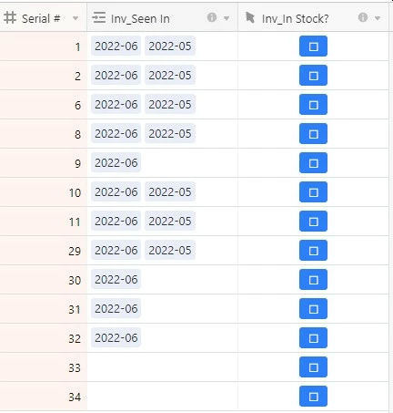

I have a database that deals with inventory for serialized items. For each item, I need to know when they have been found to be in-stock. Here’s what my setup looks like today:
  • Records are items uniquely identified by a serial number
  • One link-to field is Inv_Seen In which collects values each month that that item has been present for. As an example, one record will have been “Seen In: 2022-06” which means it was seen in June 2022. I manually type “2022-06” for each item.
  • This setup is working fine, but requires a lot of typing the same exact thing over and over again
Here’s my “dream” setup that I’d like help writing a script to achieve:
  • Records are uniquely identified by a serial number
  • One link-to field is Inv_Seen In and collects values… BUT…
  • …There is ALSO a button field called Inv_In Stock? whose action is “Run Script”. That script will populate Inv_Seen In with “2022-06” (or whatever the month currently is. I am a-okay hardcoding the month value in the script.) for just that single record for which I clicked the button.
The block for me writing the script is that I’m not sure how to pass the current record from the button field to the script. The documentation I have found so far queries for a set of records, but I have not found how to simply act on the single record that belongs to the button.
Could someone post documentation or an example to use the “button” field to pass the current record ID to a script to append text to a field for that single record?

Hi @Russell_Findlay thank you for looking at my question.
Per your suggestion, I have created a new field that writes the “inventory check dates” in my preferred format. These are now sitting in waiting in a formula field called Inv_Slug.
I see you also suggest “2: trigger based on button…” - this is precisely what I want to do! Do you have any hints on how I might be able to do that?
(At the moment, I don’t see how to connect a button to an automation. I also don’t know how to connect a button to a script to act on just the one record that the button originated from. Moreover, I understand how I could make ALL items in a certain view as “inventory seen”. What I don’t yet understand is how to selectively do one item by clicking the one button from the button field.)

@Russell_Findlay Thank you for the “no code” option. Your screenshots were informative. At the moment, I’m going to try to stick-things-out with a script though… Wish me luck.
@kuovonne Ah hah! I cannot believe I repeatedly overlooked that portion of the documentation.There’s even an example that served as my starting off point. Thank you for your help; your response is what finally made it click for me.
Here’s my existing script that I am running with. Thanks all!
// Script to add "list items" to a list with existing items via a button field button
/* Get the record */
let table = base.getTable("Items");
let view = table.getView("Inventory");
let record = await input.recordAsync("Pick a record", view); // This accepts the button field button, horray!
/* Get the intended month */
const new_month = [];
let month_table = base.getTable("Months");
let month_view = inv_table.getView("All");
new_month.push(await input.recordAsync("Pick the month", month_view)); // I still need to find a way to have this picked by the script
/* Merge with existing months */
const existing_months = record.getCellValue("Inv_Seen In");
const months = new_month.concat(existing_months)
/* Execute */
await table.updateRecordAsync(record,{"Inv_Seen In": months})
