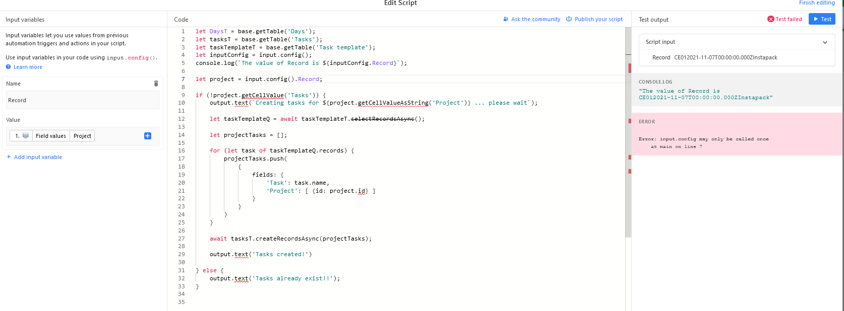

I built below script to use a filed in a new record created as input as project but it doesn’t work and I cannot understand why:
input.config() is not an asynchronous function, so you don’t need to await it’s results.
You can just use this to set your input project:
let project = input.config().Record
  • November 8, 2021

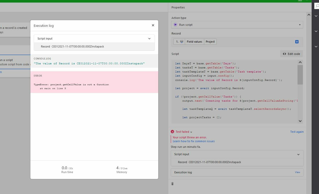

I tried but it failed again:
Welcome to the community, @Silvia_Fatti! :grinning_face_with_big_eyes: The problem now is that you’re calling input.config() more than once per the error in the sidebar. You already have this line that assigns input.config() to a variable (line 4):
let inputConfig = input.config();
All other references to your input variables should be done through that, which means that line 7 should look like this:
let project = inputConfig.Record;
Then again, if you’re only going to use the single Record input variable, you could drop line 4 and only use line 7, which means that you’re still only accessing input.config() one time.
As a side note, it’s preferred to name variables with a lowercase first letter, so I recommend changing “Record” to “record” in your input variable settings.
