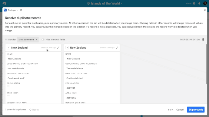

This might be relevant to some of the folks in this thread: our deduplication block is currently in beta right now! You can use it to delete duplicate records or merge individual fields from duplicate records together.
If you’re a Pro plan user and you’re interested in testing it out (and giving us your feedback!), we’d love for you to sign up using this form.
  • October 1, 2018
In case it helps, the dedupe block is now live and open to all Pro users. For more info, check out the support article: https://support.airtable.com/hc/en-us/articles/360008332253.
