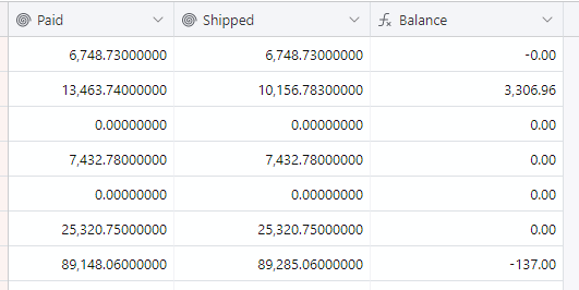

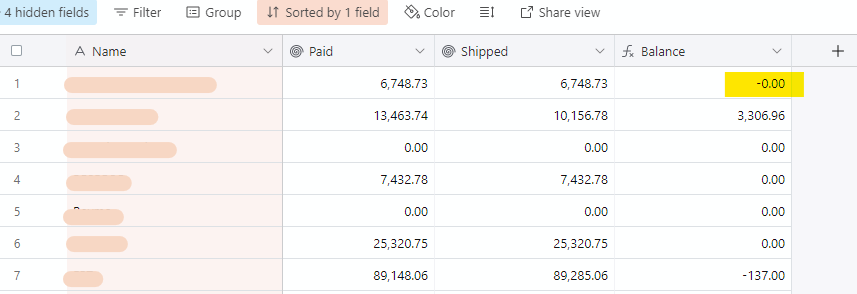

Is there any reason for -0 in the result of the simple formula as Paid-Shipped? Is it interesting, as it shows only in one row.
The last time this happened to me it was because it wasn't actually a 0 and the decimal place is being cut off, like so:

Yes, I checked that. Doesn't look like it is a precision problem.

Interesting!  Could you try adding a `ROUND()` to the "Balance" field and see whether it goes away?
The formula I used above was:
ROUND(0 - Number)
 And "Number" has a value of 0.000000001, which shows as 0s in the screenshot
If the ROUND works, it might be due to floating points, but I would open a support ticket to be certain
