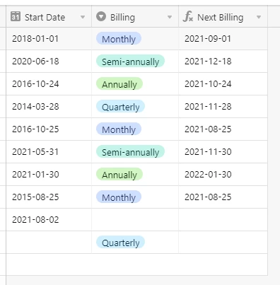

I have three fields like this:
| Start Date | Billing | Next Billing |
In the Start Date field, there’s a past date
In the Billing field, there’s a dropdown list with the values “Monthly”, “Quarterly”, “Semi-annually” and “Annually”
In the Next Billing field, I want a formula that calculates next billing date based on the values in the two previous fields. Next Billing should always be a upcoming date (or today).
Examples:
If Start Date is “2018-01-01” and Billing is “Monthly”, I want Next Billing to say “2021-09-01”
If Start Date is “2020-06-18” and Billing is “Semi-annually”, I want Next Billing to say “2021-12-18”
If Start Date is “2016-10-24” and Billing is “Annually”, I want Next Billing to say “2021-10-24”
I have tried to do this myself but I can’t work out how to do it. Can someone please help?
Thanks!

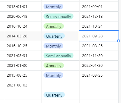

Is this what you want?
Would you like to provide any more test data?
By the way, this formula is 62 lines long.
  • August 25, 2021
That’s EXACTLY what I want! Are there any downsides of the formula being so long?

Thanks for clarifying! The only problem I can see in your test is the record with “Quarterly” as billing interval. Next Billing should be 2021-09-28, as I will bill this customer every quarter starting from March 28th. I.e March 28th, June 28th, September 28th and December 28th each year. Let me know if anything is unclear.
  • August 25, 2021
Thanks for the catch. This is what I mean about the importance of testing cases. I got mixed up between a quarter being 3 months versus 4 months. Lol. There are 4 quarters in a year, but each quarter should be only 3 months, not 4 months long.
  • August 25, 2021
Lol :slightly_smiling_face: PM me with your PayPal account and I’ll send you the money.
