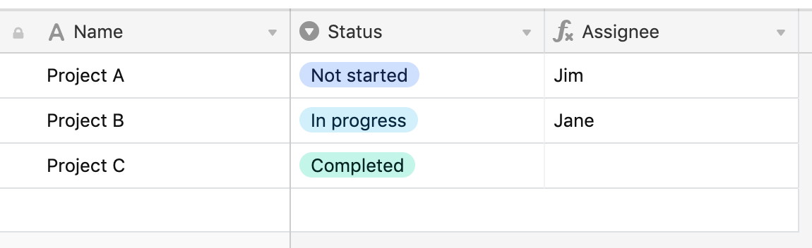

Hi @Jordan_Violet - you could simply have a formula field based on the status field:
SWITCH(Status, 'Not started', 'Jim', 'In progress', 'Jane', 'Completed', '')
JB
  • April 22, 2019
Thanks for the reply! Unfortunately, because it is a function field and not an assignee field, I won’t get the benefits of the assignee field such as notifications.
