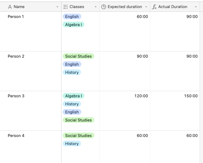

Hello, I am having to add hours ("duration") to a field and outputting to a new field where a formula would be developed, however, I am not sure how to format the formula for the duration; here is my formula:
FIND("Algebra I", {Requires Additional Hours?}), {30:00},
SUM({Total Hours Required}, {30:00})
"{30:00}" in both instances comes out red, meaning it is wrong, however, what I need to do is add 30 hours to the "{Total Hours Required}" field. Basically, if Algebra 1 is found in this drop-down menu "{Requires Additional Hours?}", it takes the value within "Total Hours Required" and is supposed to ad 30 hours and output it to this field. If Algebra 1 is not found, it stays at 30 hours, hinting at the first "{30:00}" in the IF() formula.
Thanks in advance!

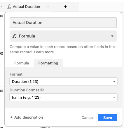

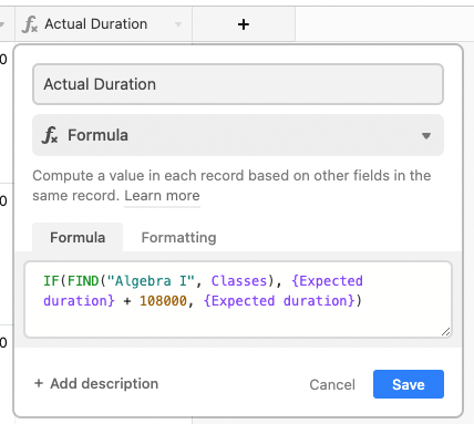

Juan,
Duration is stored in seconds, so if you want to add 30 hours, add 108,000. Also, make sure your field's formatting is set to Duration.
Ron_Daniel
  • January 24, 2023
Juan,
bruceconsulting
Forum|alt.badge.img+13
Hi, looks like you are putting the hours you want to add in curly brackets which Airtable sees as a field name.  Try removing the brackets and just use the number 30.
