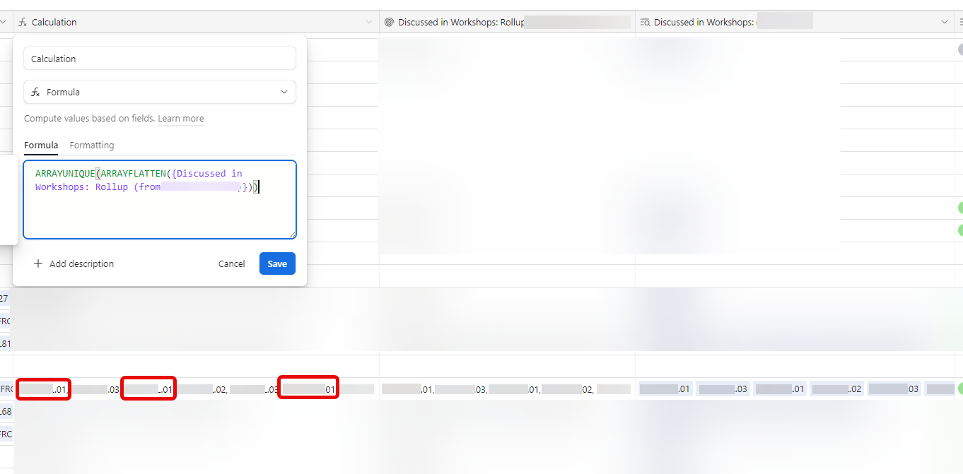

Hi everyone,
I am trying to get unique values from a lookup field. I have tried the solution suggested in: Solved: Exclude Duplicate/Repeating Values via Lookup or R... - Airtable Community. by  @kuovonne. Which stated:
  1. Create a rollup field that rolls up the multi-select field. Set the formula to values. Save the rollup field.
  2. Convert the rollup field to a lookup field. Notice that the lookup will be formatted as plain text instead of the usual pill format.
  3. Create a new formula field that refers to the lookup field (that used to be a rollup) and use the formula ARRAYJOIN(ARRAYUNIQUE(ARRAYFLATTEN({lookup field})), ", ")

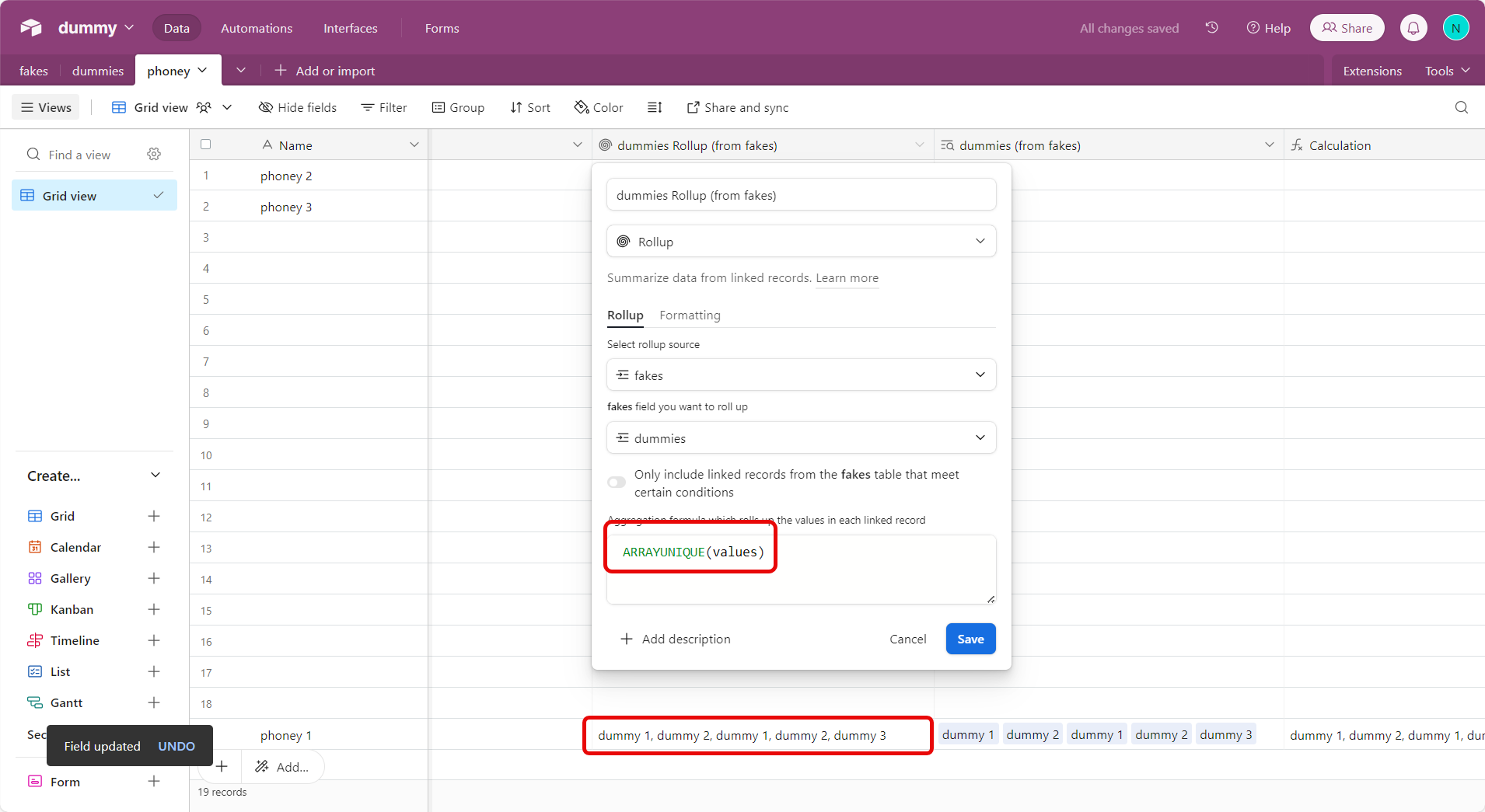

But this does not seem to work for me, as converting the rollup back to a lookup, changes the formatting back to pi lls.
In the screenshot provided you can see the formula I am using, as well as both the rollup and lookup field. I have tried different combinations of using ArrayFlatten and ArrayUnique across the rollup and formula but nothing seems to work...
Any help would be greatly appreciated.

Hi @ScottWorld
Thanks for your reply. Unfortunately that didn't work, the formula field returns the same data (with the duplicates) as in the screenshot provided initially.

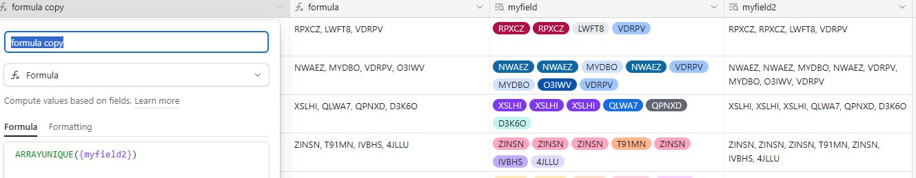

based on your screenshot, it's not clear why your rollup field still exists and which field you are referring in your formula. For curiosity, I just tried solution you mentioned and it worked.
On my example screenshot, myfield - usual lookup
I just created rollup field myfield2, converted it to lookup (values didn't change format - still plain text) and used simple ARRAYUNIQUE formula against it - worked as written in solution.
I think, in your case, there is something wrong with step 2.

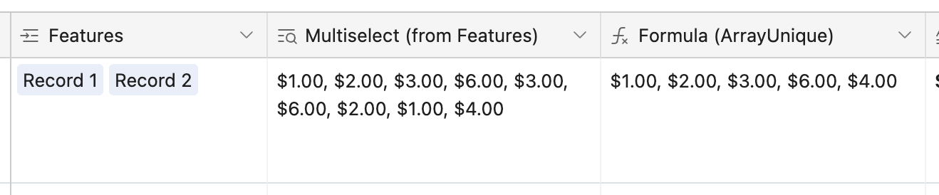

Hi @ScottWorld
Strange. It works for me. See screenshot below.

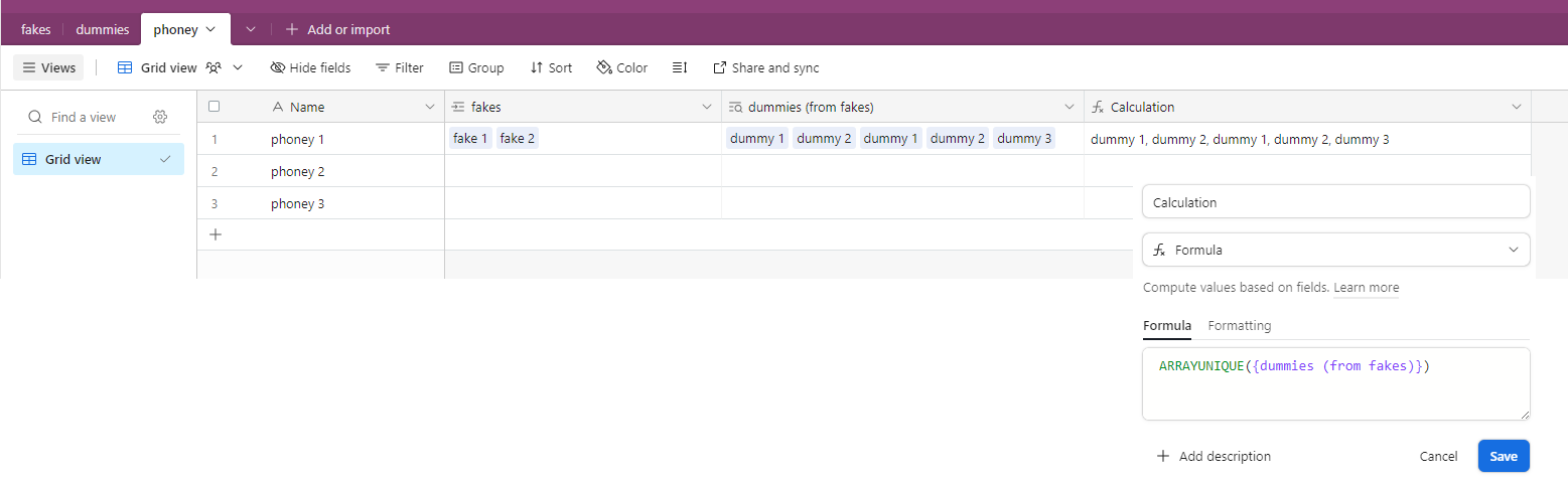

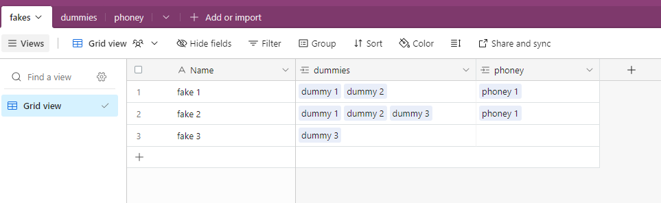

When I create a lookup field in the ways you suggest, the pill-style formatting is still present. This is, in my opinion, what is blocking the ARRAYUNIQUE() from working correctly. @Alexey_Gusev  suggested creating a rollup first and then converting it to lookup to get the plain text formatting, instead of the pill-style. For some reason I am struggling to do this conversion.

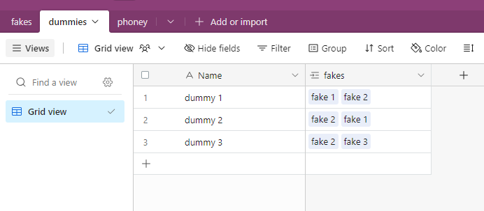

On another note, I have recreated the data structure with fake entries, to show you better what my issue is:
As you can see, the calculation in the last screenshot does not return unique values.

I know those are linked fields. What you are suggesting is the first thing I tried, before even consulting the community 🙂 . But when my duplicates persisted (see screenshot below), I tried looking for solutions and found similar issues in the thread that I referenced in my original post, hence why you may thought that I was having issues with a multiselect field. I indeed did not clarify that I was dealing with linked fields.
Anyways, in the screenshot below I re-tried what you suggested, but as you can see, duplicates persist.
I have also tried combinations with ArrayFlatten, but no luck.
I hope I understood you correctly and this is what you were suggesting. Thank you for bearing with me and your responses so far.

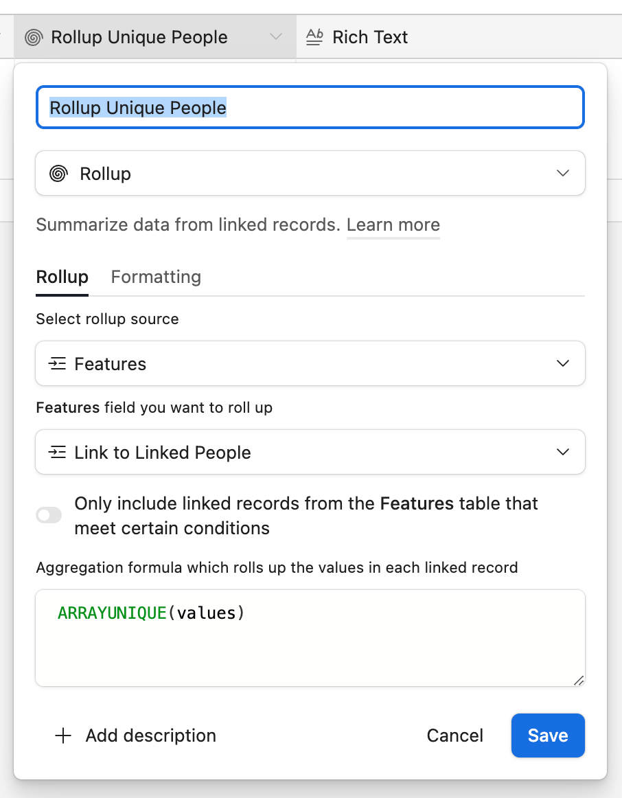

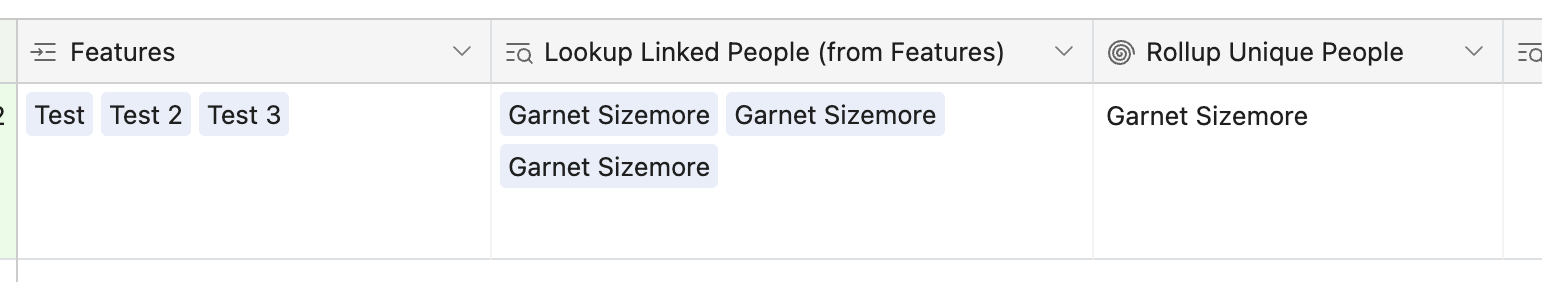

Right, I thought you were using multi-select fields because that's what you said in your original post. Maybe you were just quoting that from another thread.
However, your setup with that rollup field looks perfectly fine to me, and that is exactly how I have it setup on my end which is working properly.
So I have no idea why yours is not working properly while mine is working properly.
You may want to open up a support ticket with support@airtable.com to have them take a look at this, and write back here with what they tell you!
You can see my 3 screenshots below. (The lookup field is just there to show the duplicates, but it's not required.)
You can see from my 3 screenshots above that it's working just fine on my end, so I'm not sure why it's not working for you. I would definitely send an email to support@airtable.com for them to look into this for you! Please post back with whatever they say!

I think your example is working because the array is [['Garnet Sizemore'],['Garnet Sizemore'],['Garnet Sizemore']] ----> so ARRAYUNIQUE returns [['Garnet Sizemore']].
In my case the array is [['dummy 1', 'dummy 2'], ['dummy 1', 'dummy 2', 'dummy 3']] ----> so ARRAYUNIQUE recognizes it as two different "elements"....
This is why I originally also tried ARRAYUNIQUE(ARRAYFLATTEN(...)), to remove the nesting, but that also did not work...
I am sorry for not clarifying earlier that I was dealing with linked fields, it was indeed not clear from my original post.
I will contact the Airtable support and update this thread when they get back to me. Thank you for your patience and guidance!

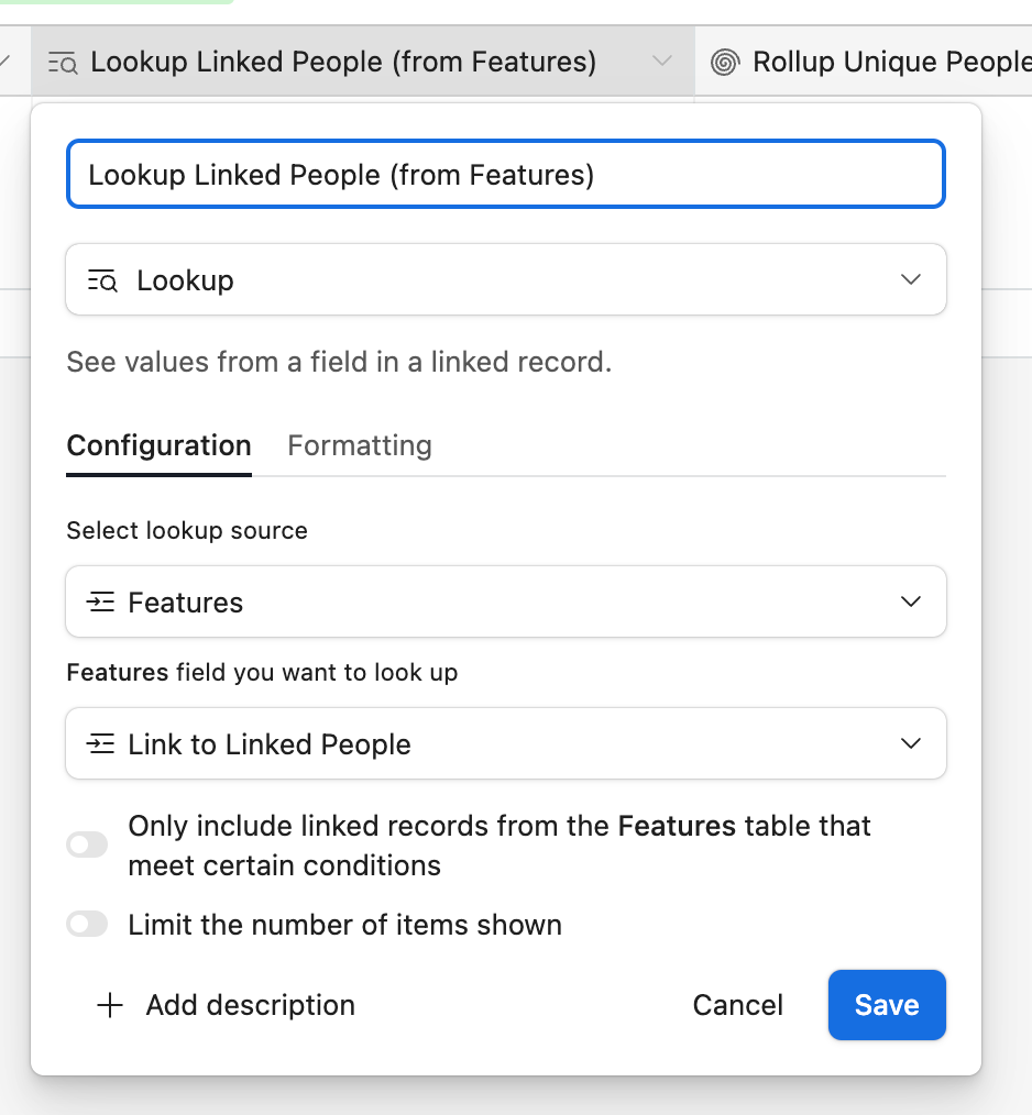

@NoreG
Oh, you're right! Duh! 🤦
You are correct that my example is completely different than your example, because all of my values are single-value arrays.
As soon as I make my values multiple-value arrays, then I get the same incorrect results as you.
And yes, this is a very longstanding (and very annoying) bug in Airtable.
But here is the solution:
Your lookup field needs to be created in the LINKED TABLE, not the main table that you're currently working in (i.e. NOT the table where you want to see the results).
So take these steps to solve it:
1. Go to your LINKED TABLE. In my example, that would be the "Features" table. In your example, that would be the "fakes" table.
2. Find the LINKED RECORD FIELD in that table. in my example, that would be the "Link to Linked People" field. In your example, that would be the "Dummies" field.
3. Right-click on that field header and add a lookup field. Choose the primary field as your lookup field. What this results in is that you are going to see the EXACT SAME VALUES in BOTH your linked record field AND your lookup field.
4. Now finally, you can go back to your main table (i.e. the table where you want to see the results). You still need the linked record field that you've already got setup, but you just need to add one rollup field based on that linked record field. And the rollup field will point to your brand new lookup field instead, with the formula ARRAYUNIQUE(values)
And that's how you workaround this very annoying & very strange bug in Airtable! 😅
