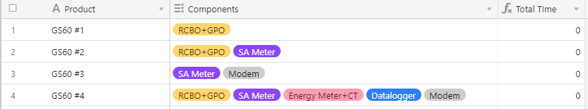

Hello,
I am looking for a method/formula to calculate the total time allocated for products (for manufacturing) which have different components with pre-defined times.
For instance, A product called “GS60” can be manufactured from one or mix of “RCBO+GPO”, “SA Meter”, “Modem” and so on. I have pre-defined time for each component such as “RCBO+GPO = 1h”, "SA Meter = 1:5h etc.
Once I select the components from multiselect field, it should be calculated the total time for each product in “Total Time” field.
Thanks

Welcome to the community, @Asanka_Napagoda! :grinning_face_with_big_eyes:
For each piece, you could use the FIND() function to determine if it exists in the {Components} field, then check to see if that number is greater than zero. For example:
FIND("RCBO+GPO", Components) > 0
That expression will return 1 or 0: 1 if the item is found, zero otherwise. Multiply that result by the number of hours that this component requires.
(FIND("RCBO+GPO", Components) > 0) * 1
That will return the appropriate time if the piece exists, or zero if not. Add all of these calculations together, and you get the total time for all selected pieces. Here’s a slightly larger example:
((FIND("RCBO+GPO", Components) > 0) * 1) +
((FIND("SA Meter", Components) > 0) * 1.5) +
((FIND("Modem", Components) > 0) * 0.75) +
...etc

@Justin_Barrett :grinning_face_with_big_eyes: Genius. That does the job. Thank you so much.
