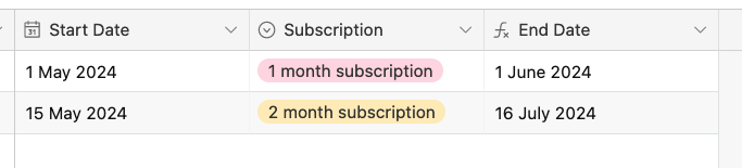

Does this look right?
DATEADD( {Start Date}, SWITCH( Subscription, '1 month subscription', 31, '2 month subscription', 62 ), 'days' )

This is exactly what i needed! Don't understand how i didn't think of just not using the date dependency and just using a formula instead...
