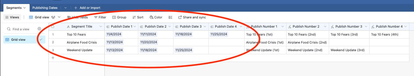

We are a publishing company and we publish individual pieces of content on multiple dates.  I have a different sheet that I'd like to have all of those dates be put together into 1 cell (see attached). Is there a way to do that so that if I fill in a date in the "Publish Date 1", "Publish Date 2", etc. cells, that it will automatically add them into the column on the far right that is referencing another sheet?  I did it manually in the attached screenshot just to show what I would like to happen. Thanks in advance!

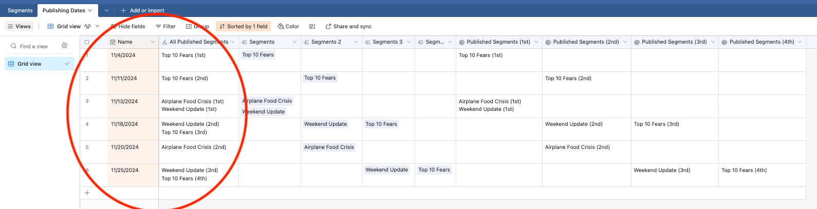

It got a little complicated unfortunately, but I wanted to end up with another view, similar to what's attached), where I can show all segments scheduled to publish on a particular day, whether they're republishing or original content.

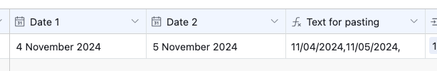

Doable, but kinda tricky!  You'd need a formula field that'd help you concat all the dates together like this:
IF( {Date 1}, DATETIME_FORMAT({Date 1}, 'MM/DD/YYYY') & ',' ) & IF( {Date 2}, DATETIME_FORMAT({Date 2}, 'MM/DD/YYYY') & ',' )
And then you'd use an automation to paste that text value into the linked field to the other table:

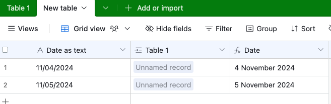

The main consideration here is that you're going to need to convert the primary field of your linked table to a text field in order for this to work, and if you want the date for filtering etc purposes you'd just use a formula field to parse it again:
