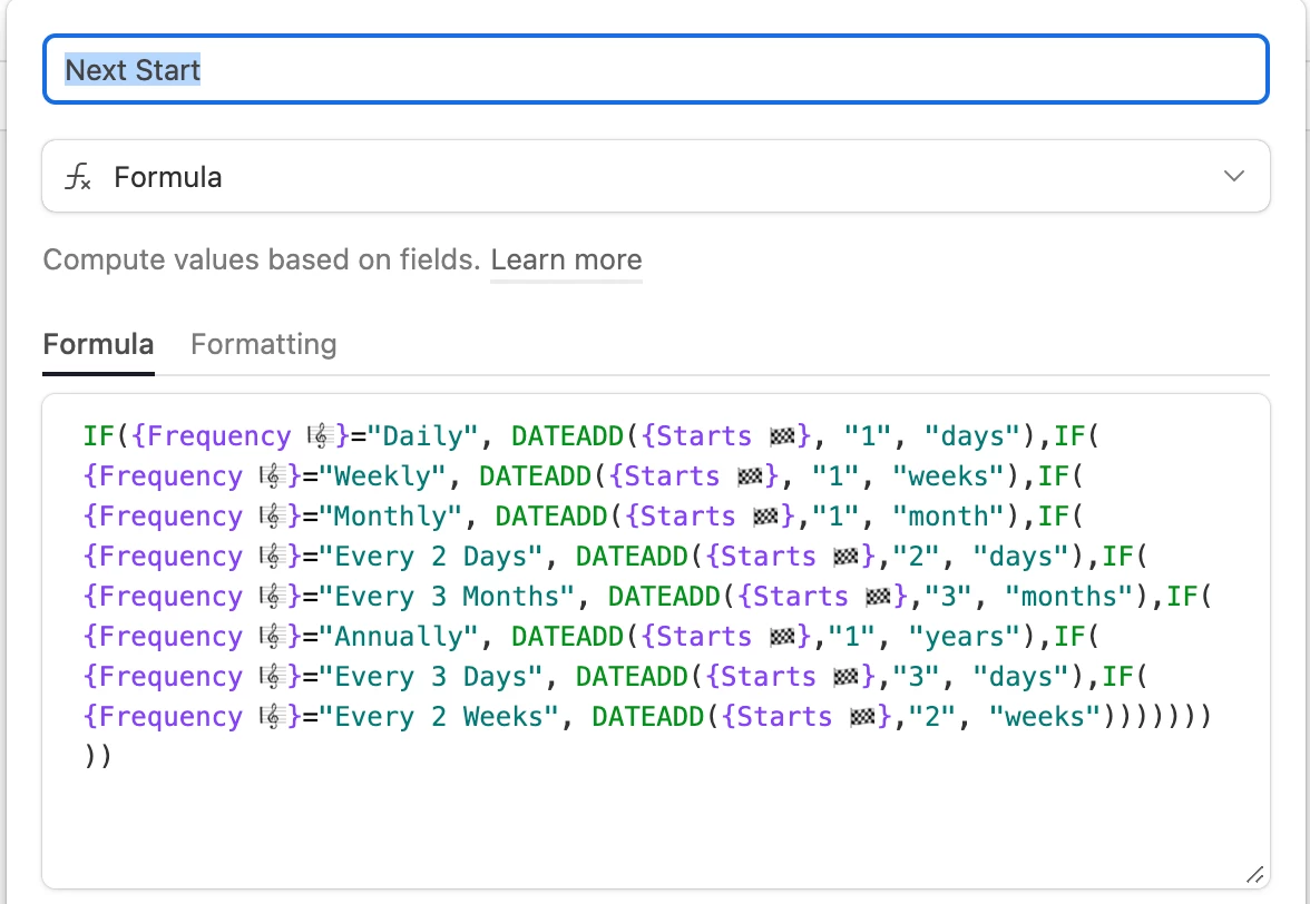

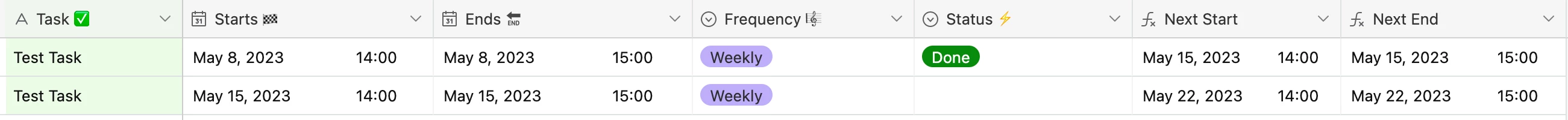

In my to-do list base, I have to input the Start and End dates and based on the Frequency of the task the formula of the (Next Start date / Next End date) get created (attached the base structure).

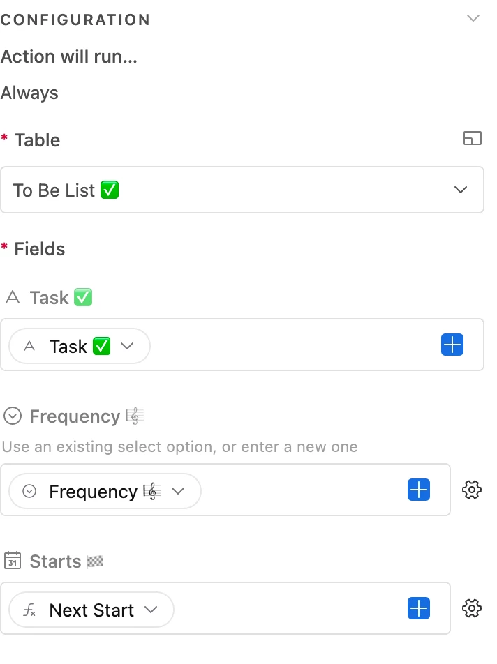

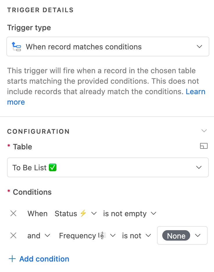

In the automation, once I mark a reoccurring task as done it appears again but with the new dates (attached the trigger and action). The is perfectly working for me. The frequencies I have are (annually, monthly, weekly, every 3 weeks, every 2 days, daily etc...).
You can see in the Next Start Formula's screenshot how the Next Start formula relays on the chosen frequency.
What I am not sure on how to achieve is, let's say I want a certain task to be reoccurring every Wednesday and Friday (so twice a week but on specific days), how can I integrate that with the Next Start Formula? Or should I have a completely different formulas for this.

Ah I see!  Check out this thread where you'll be able to find a formula that returns the next Friday from today.  You should be able to integrate it into your Next Start formula fine, and you'll just need to modify it to get you the next Wednesday as well?
