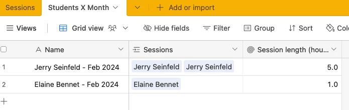

I'd then use an automation to copy the value of that formula field and paste it into a linked field to that new table I mentioned.  In the new table, I'd then create rollups etc to display the data from the multiple sessions the student had that month

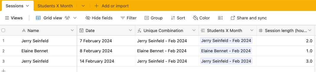

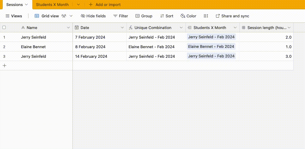

Sure, here's the formula I used for the examples below:
Name & " - " & DATETIME_FORMAT(Date, 'MMM YYYY')
And as you can see, it links the sessions from the same student and month together, allowing you to create the rollups/lookups you'd want:
