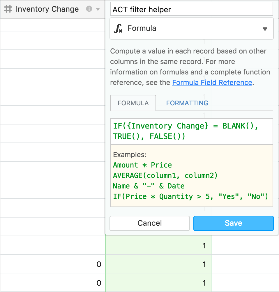

When I’m using Blank() in a formula (to flag empty fields) it also counts the number ‘0’ as a blank, and the other way around.
So when I have a formula that says {MyNumberField} = 0 it also registers the empty fields as zeroes.
Has this always been the case? At the very least I’d expect the more specific {MyNumberField} = Blank() to neglect ‘0’ fields.

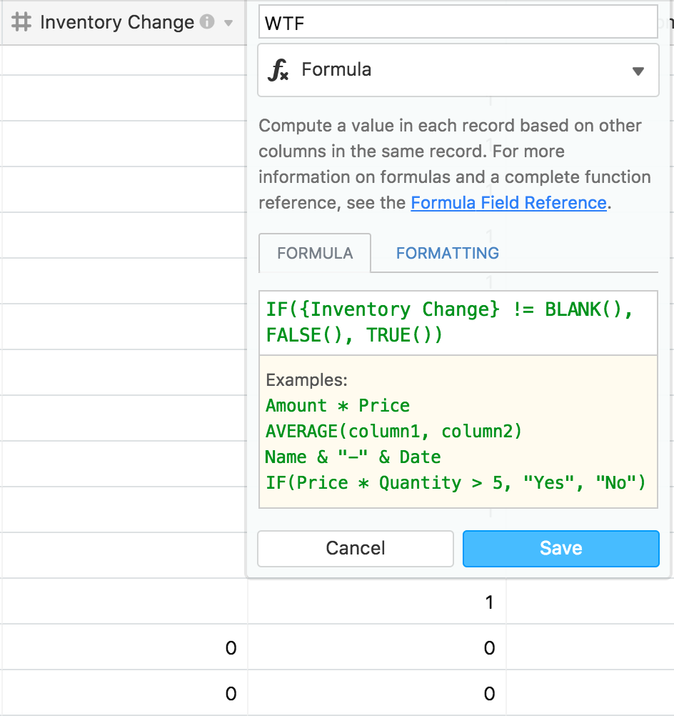

I figured out why I thought it was working before; it does give the correct result when you reverse the argument. In my example:
IF({Inventory Change} != BLANK(), FALSE(), TRUE())
In this case ‘0’ is not equal to BLANK().

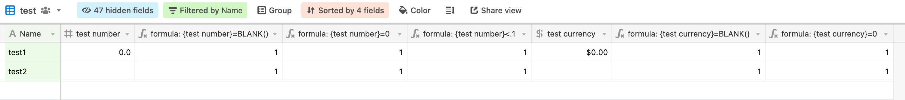

currency and number fields do not handle “0” and blank values differently: “field = BLANK()” results in TRUE if blank OR zero “0” ( OR(field = BLANK(), field = 0 ), results in FALSE if checking for “field = 0” even if you enter zero “0” dollars as a value
row1 field = 0: blank = TRUE, field = 0 TRUE
row2 field = empty: blank = TRUE, field = 0 TRUE
Also:
{test number}<.1 evaluates to true when {test number} = 0
{test number}<.1 evaluates to true when {test number} is blank
