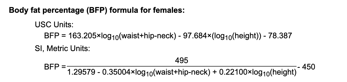

I'm trying to create a body fat calculator formula based on waist (cm) , hip (cm) and neck (cm)
The calculation I'm trying to make as a formula (for women) is this one:

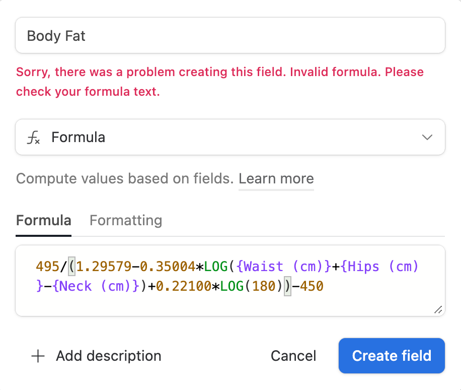

And this is what I came up with in Airtable, but it says: Invalid formula:
495/(1.29579−0.35004*LOG({Waist (cm)}+{Hips (cm)}-{Neck (cm)})+0.22100*LOG(180))-450
For now I just want to test it and use it for myself, so I've plug in my height directly in the formula which is 180cm.
In my table I have a field for each measurements.
What am I doing wrong and how can I make it work?
Your formula's fine actually, it's just that one of your dashes is...weird?  I replaced the dash here:
1.29579−0.35004
 And now it works fine
Here's the working formula:
495 / ( 1.29579 - 0.35004 * LOG( ( {Waist (cm)} + {Hips (cm)} - {Neck (cm)} ) ) + 0.22100 * LOG( 180 ) ) - 450

Thank you so much, works perfectly now 🙂
