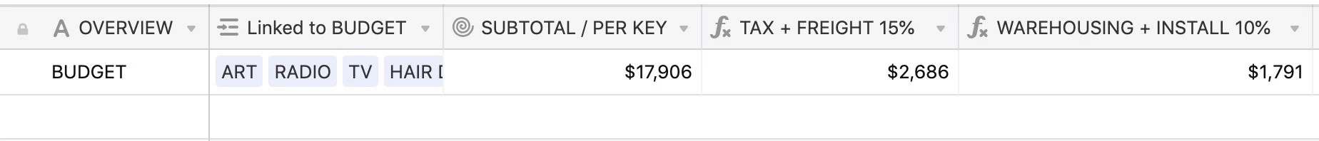

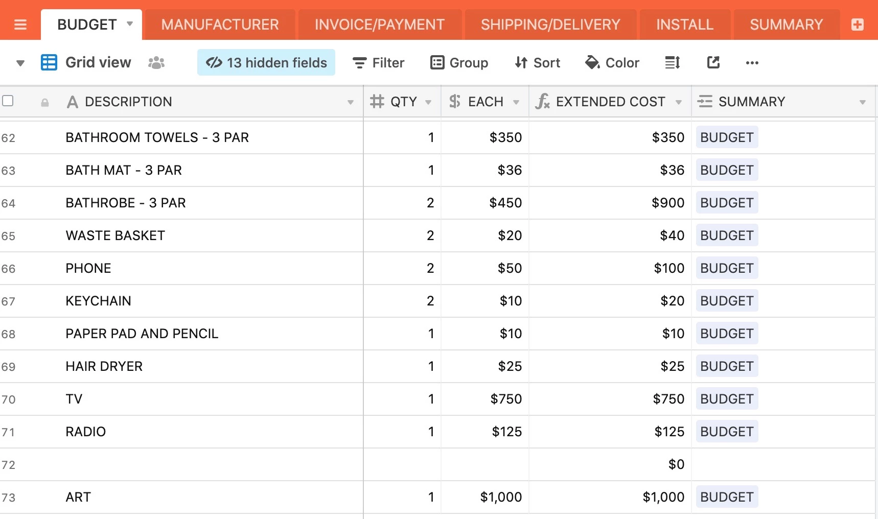

Thank you! Finally figured it out the end of the day yesterday - and your example confirmed my steps. Appreciate it.
Using it for business… The initial step for setting up the linked field with all the records from the budget table was a bit tedious since I had 63 records - and I have to add each record into the one new record right? (Clicking on the + sign each time… Or is there a way to copy all the records and paste them into the one new record in one go?)

You can copy and paste the linked record. So you could have (and can in the future) linked the first one, copied it’s value, selected all the rest of the records, and pasted that value into all of them at once.
Also, since you only have the one record in your SUMMARY table, when you are linking a new record from your BUDGET table, you can select that SUMMARY field and just hit Enter twice – the first time will effectively click the + to open the selection menu, and the second time will select the top option, which in your case is the only option. Makes for a pretty quick workflow when adding new records one at a time to your BUDGET table.
Looks like you have it working as you need it to!
