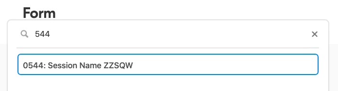

In your table that’s populated by the form, you would have a link field to select from that training table. If someone using your form attended “Session Name ZZSQW”, they just have to type its number—or even part of its number—and it will be isolated for selection:
Thank you, that will work well for users.
