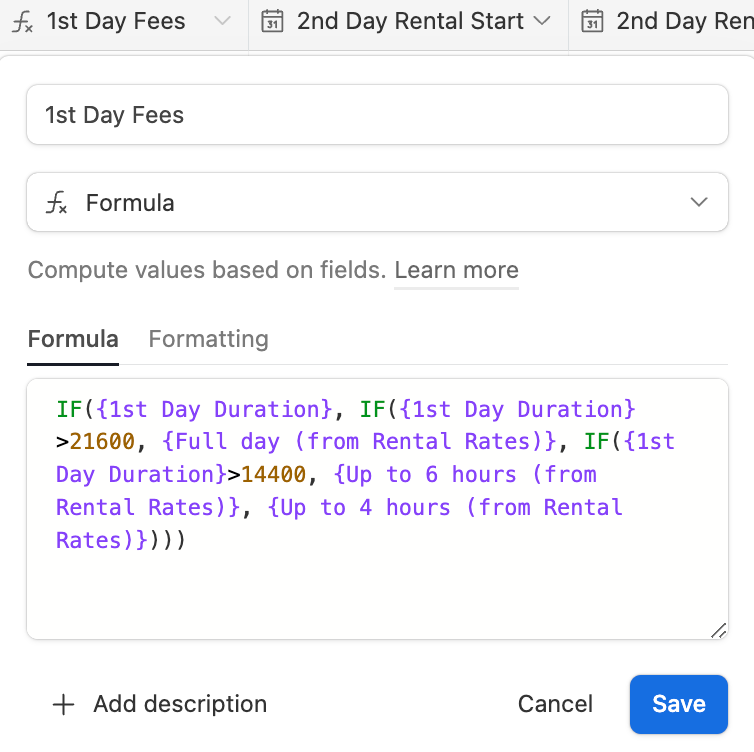

Hello. Still fairly new to Airtable and working to better understand formulas. I'm looking for input on the following.
We have a rental space where rates are set based on duration (up to 4 hours, up to 6 hours, all day). I've set up a table for Rental Rates. Separately, I have a table for rental details, and this includes a duration field ("1st Day Duration") calculated based on rental start and end times.
I'm trying to figure out how to create a formula that calculates the correct rental rate based on the duration and then pulling the correct rental rate. So for example, if a duration is 3 hours, the fee would be $x (since that's the "Up to 4 hours" fee). But if the duration is 7 hours, the fee would be $x since it would be a "Full day" rental.

I understand that you have a table with your rental rates and a table with rental details. You'll no doubt have linked those 2 so you can lookup the current rates in your rental details record. For new rates (for new rentals) I would suggest creating new records in the rental rates table (maybe use start and end dates).
In the rental details table, try this formula:
IF(Duration, IF(Duration>21600, {rate full day (from current rate)}, IF(Duration>14400, {rate >4h (from current rate)}, {rate <4h (from current rate)})))
Note that duration stores it value in seconds. Replace "Duration" with your duration field (so between { } ). The {... (from current rate)} are lookup fields from your rental rates table.

VALUE(IF(Duration, IF(Duration>21600, "1000", IF(Duration>14400, "500", "300"))))
Duration field stores it data in seconds, so 6h = 21600 ($1000), 4h = 14400 (=$500); rest is less than 4h and lowest rate ($300). You can change the duration and rates of course.

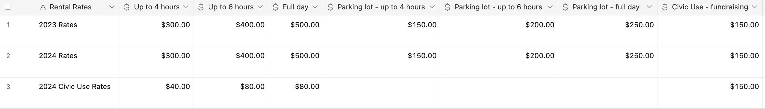

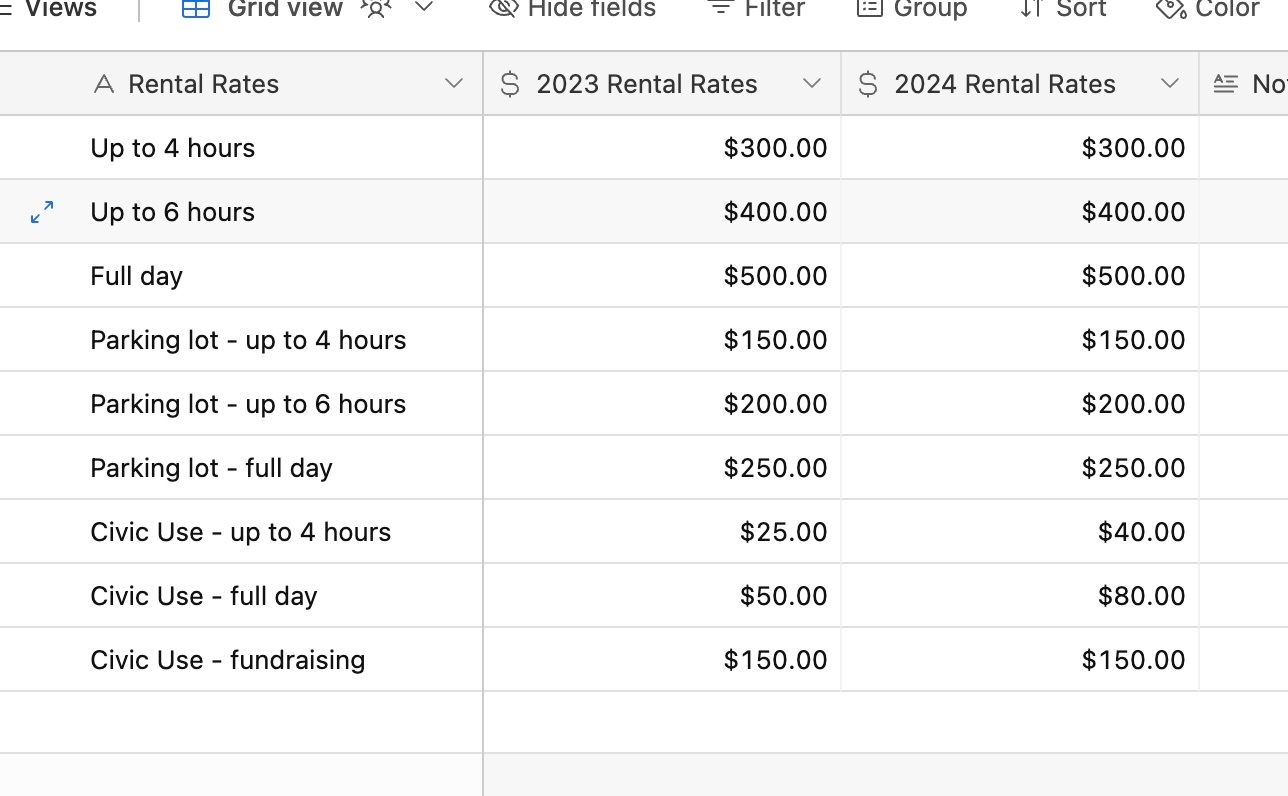

Here's our rates table...
Rows 2 and 3 are referenced in a separate table based on certain conditions.

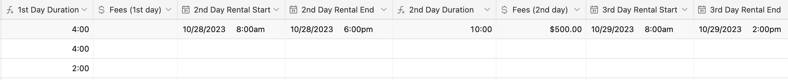

Then, there are multiple columns in the main table I'm working with that have formulas pulling the correct amounts from that rates table. Each day booked has a total...

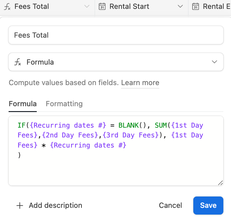

Then there is a Fees Total column that adds up each of daily fees that exist.
