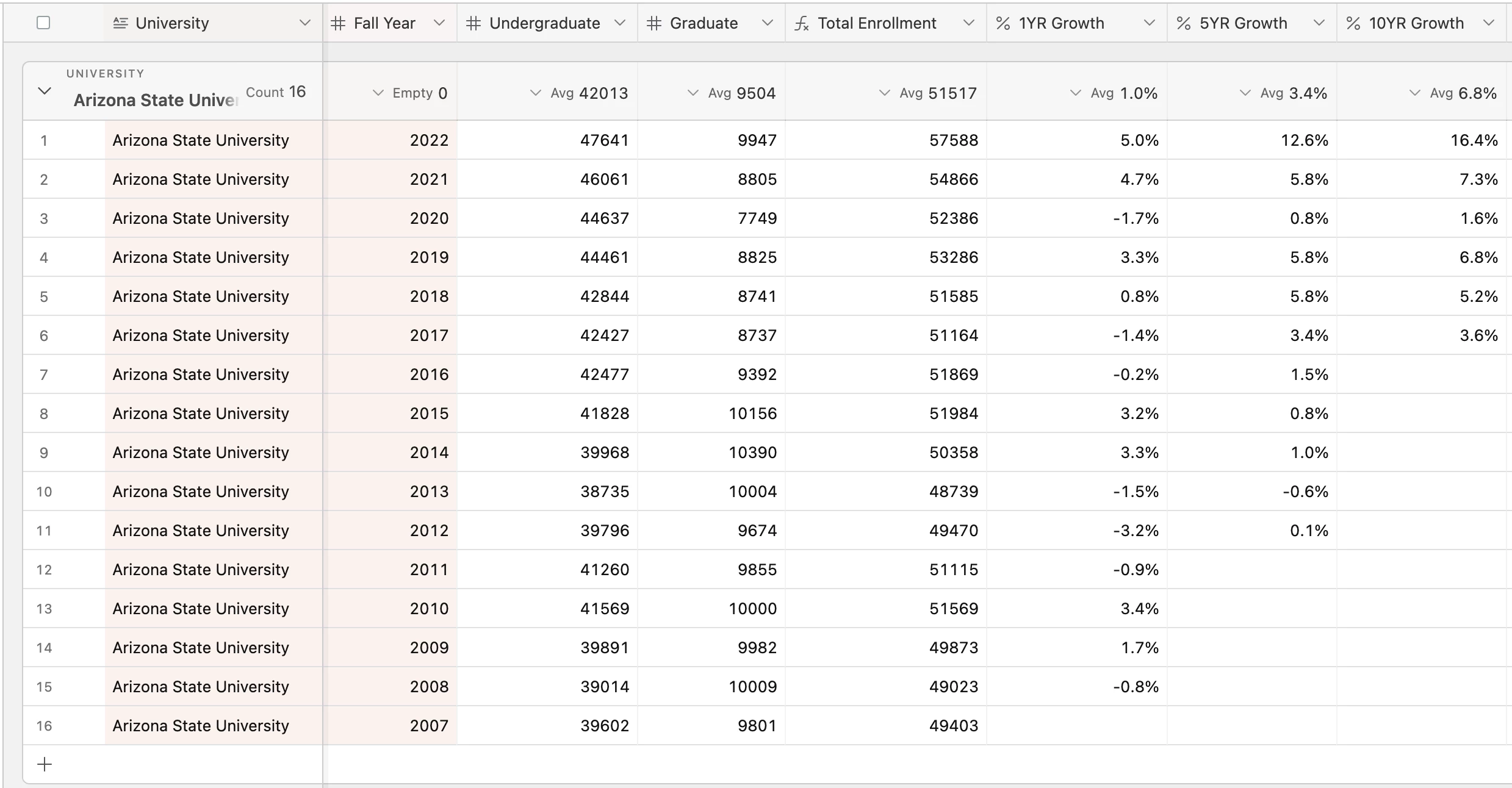

Hi All -
I'm struggling with creating calculations on the base shown below. What I'm trying to do is calculate the % change in total enrollment growth by 1YR, 5YR and 10YR between Fall Years for each university (it would be a changing calculation with each new Fall Year record added for each university).
While this is easy to do with a vlookup in Excel (i.e. matching University, Fall Year and Total Enrollment with Fall Year-1, Fall Year-5, Fall Year-10), I'm struggling with a finding solution here in Airtable.
I'm feeling like it might require a linked Lookup table (or adding another field) to make it work. But just not sure how to go about it. Or, if it's even possible between records in Airtable.
The numbers shown below for the % growth fields were imported from Excel.
Any help would be greatly appreciated!
Thanks!

Hi Dimitris - Thanks for the response! Conceptually, I get what you are saying, but having some difficulty visualizing/figuring out how to actually do that. It's been a while since I've setup linked tables and lookup fields.
Additionally, each Fall Year, I will add another record in the primary table for each university, i.e. 2023, which would then become the most recent Total Enrollment that would need to be calculated from, i.e. 1YR Growth from the previous total enrollment, and 5YR Growth and 10YR Growth from the most recent total enrollment. The -1, -5 and -10 Fall Year's would always be based upon the most recent record entry for each university, which will be variable (i.e. some schools will have 2022 as the most recent, others 2021 or 2020, for example). While that formula can be created in Excel or a database calculation, I may be asking too much of Airtable here. My goal was simple to be able to have that 1YR, 5YR and 10YR growth calculated dynamically, vs. having to manually calculate and enter it.
Thanks for your help Dimitris!

Hi Dimitris -
Thanks for your help! I've tried to setup this up and I'm just not fully grasping what I need to do with Table 2.
I've setup a column with the University Name, but am at a loss of what to select when creating linked records and which specific columns in Table 1 to link to. When I select "Link to to Record" when adding a field to Table 2, it asks me which lookup fields to include. I'm assuming it would include "University, Fall Year and Total Enrollment," which just adds three blank fields in Table 2. I'm not quite sure how to add lookup and rollup fields. Everything I've tried just ends up with blank cells (Table 2 - Universities):
Table 1 (Enrollment) for reference:
I just can't figure this out, even before I get to trying to setup calculations for 1, 5 and 10 year growth-which is a whole other issue calculating, as the Fall Year records will change from year to year (i.e. most recent records - 1 year, 5 year and 10 year growth). Thanks! Howard 
Any help would be greatly appreciated.  

Dimitris -
Thank you so much for this!!! I greatly appreciate your time helping me with this. I'm getting that you just have to think about things differently when working with Airtable. It seems you have to create another table that pulls from your original table in order to do any calculations or run automations. I really didn't think it was going to be this complex.
I'm struggling with what to do next.
I'm assuming calculating a 1YR or 5YR growth % change would have to be done with some calculation of {Fall Year} - 1 or {Fall Year} - 5, etc. i.e. (Total Enrollment / Total Enrollment=Fall Year-5)/Total Enrollment) via an automation or formula that looks for University Name, Total Enrollment and Fall Year. I just can't find anything in the discussions or Airtable examples that demonstrates something similar.
This was easy to do with an if/then vlookup formula in Excel, but I have spent way too many hours trying to figure it out with Airtable. I have greatly appreciated your help, but feeling a little greedy at this point!
