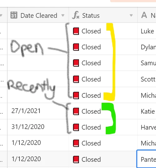

Thank you. However I still can’t get this to work. The formula I’m using is now:
IF(OR(DATETIME_DIFF({Date Cleared},NOW(),‘days’)<30,“ :open_book: Recently Closed”,DATETIME_DIFF({Date Cleared},NOW(),‘days’)>30),“ :closed_book: Closed”,“ :exclamation: Open”)
But everything is showing as “Closed” … any ideas? :woman_shrugging:
I don’t think you need the “OR”. But first, start small ok? Try part of your formula first to see what values you see. It might surprise you.
Then, build up from there. As I said before if you wrap your formula in IF({Date Cleared}, #ALL OF YOUR IF FORMULAS#, “Open”), then it should handle the “Open” rows fine.
Let me know what you find.
